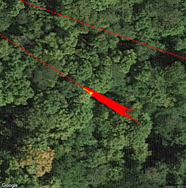

@Jnnyr I think your P3 is here
That's coordinates 43.67295, -72.791569
The multiple paths at the very end is due to the inaccuracy of GPS.
I also believe the aircraft is at that same location. Based on Gimbal Yaw, Roll, and Pitch behavior at their end does not look like the aircraft flew any further.
If I can I will try to get to it however it is a rather dense forest and probably impossible to bushwack to it.
Thanks for the help.
If you have any plans at all of flying again over that kind of terrain, you seriously need to invest into a decent GPS Tracker.

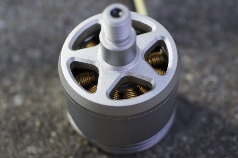

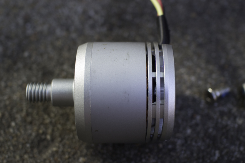

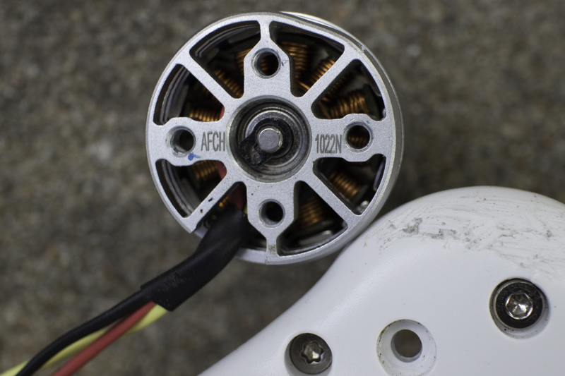

Thank you very much for that clarification. I find it odd that those numbers aren't on the motor some where. Did you know it was CCW by the black dot in the center of the spindle ?
Are you trying to trick me ? lol I believe the black dots are on the CW Motors :)
No, not at all. It's the only motor that's visually PHYSICALLY damaged from a pretty heavy crash. It's the only motor I've removed from the carcas so far. I need to know which motor to order so I can continue with what's going to be a MAJOR repair process. I was hoping the numbers in the picture would indicate exactly which one it is. Apparently that isn't the case ?
