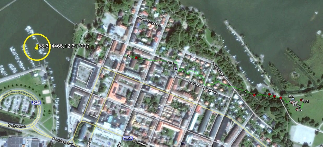

Im sad becuse yesterday i was flying my p3a for second time on a big open area, i had beginners mode on but suddenly my drone just flew away and i couldent steer it. I will post my flightrecord log here and hopes someone could help me with advice. I even uploaded it on healtydrones and get a yellow line but i couldent find my drone at the end of that line.

At 10m 2.5s in your flight, the home point was reset to the location circled in yellow below. Did you see the prompt asking you to return to the original home point or your current location?
Your Phantom had enough battery power to make it to the new home point, so it most likely landed in the water.
no i couldent do anything. thanks for yr support btw
Are you saying you never saw a prompt asking you to return to the original home point or your current location?
i dont think so i get panic when it just began to flew away from me i run after and tried to get control of it. and i had it in beginners mode, it was my 2nd flight. how did you fint that yellow circle in water?
See the link in post #2 above. You can download a CSV file under the map on that page. The CSV file shows the home point location throughout the flight.
