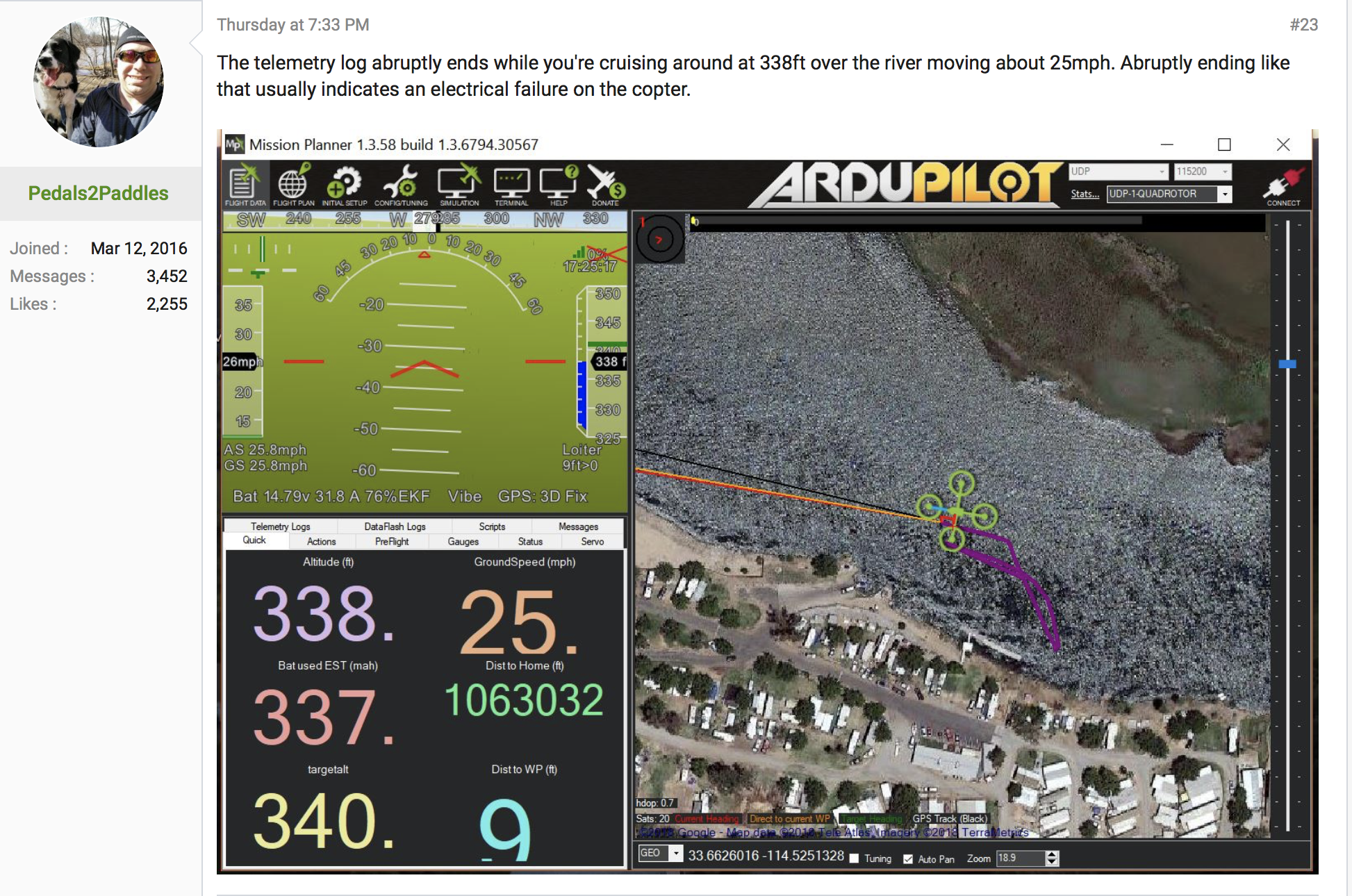

Got this from 3DR and P2P read the logs .
