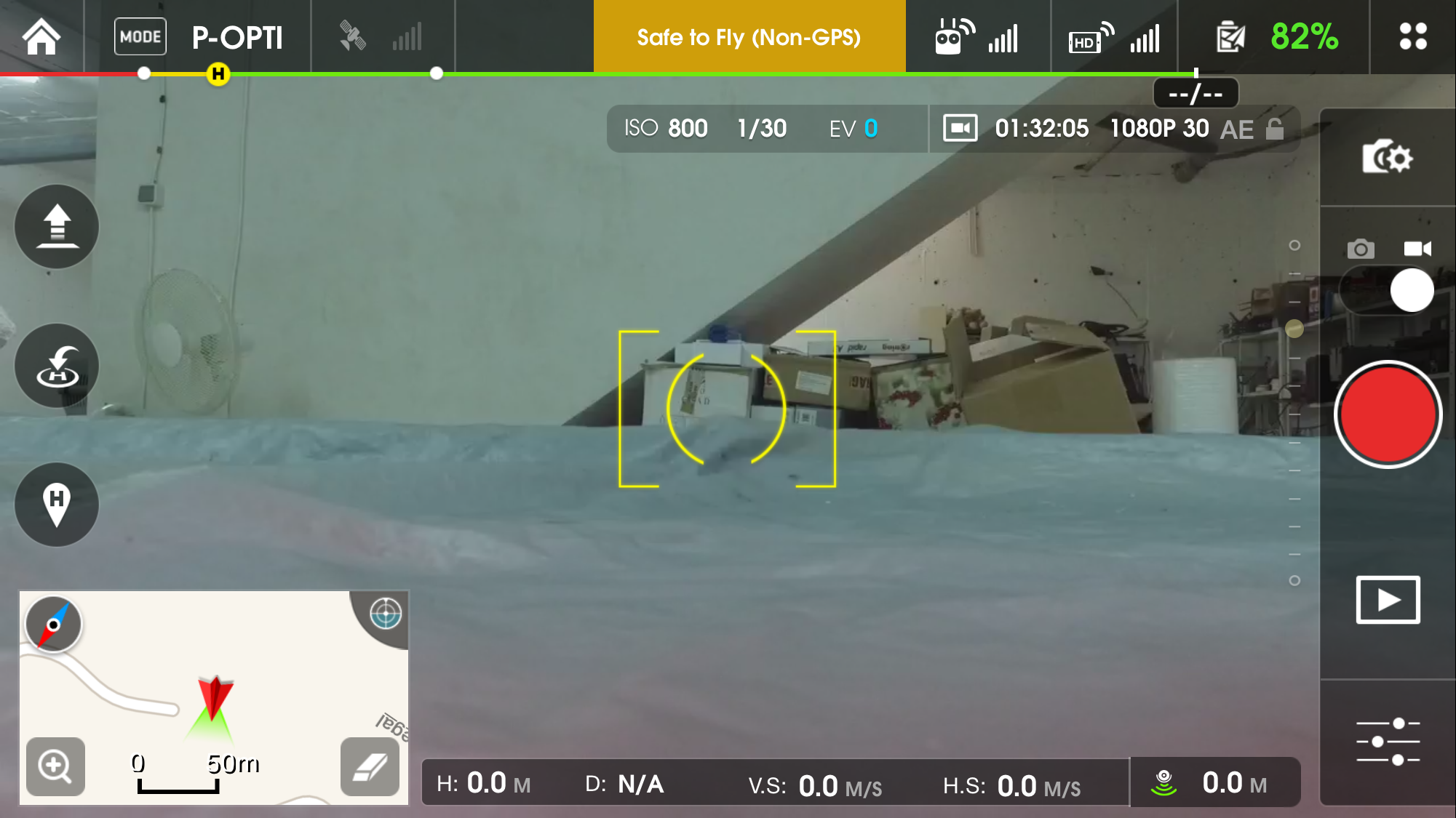

But how do you get it to come up ?
I am talking about the yellow box and inner circle (not the blue one)
How do you get centre point reference to come on ?
I think you just press/tap on the center of the screen, and it appears, allowing you to drag in any direction, to control the camera view, or keep a subject in view as you fly by on a course lock.

Ok Chris that is interesting, what I see if I touch the screen to adjust exposure and then touch x to close exposure box is this.
The yellow box and circle fad after a couple of seconds.View attachment 23223
That looks more like point or spot metering for exposure (rather than using the whole picture to work out exposure) the "center point" I showed how to turn on in my pic is a composition guide. Like the grid lines.
Thanks Chris, think you are right.
