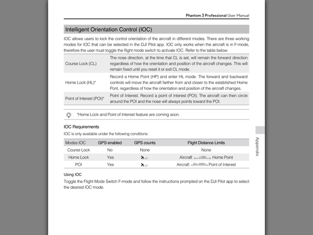

Interesting, the manual states nil GPS during CL, but I've experienced no drift during CL.

Course Lock by it's very name should hold a course. Unlike simply following a heading, holding a course includes compensating for drift. Which would require GPS. Otherwise it should be called Heading Lock.

That is what I thought would happen. When it says in the manual "GPS Counts" I think it is a bad translation of whether or not GPS matters or is necessary in that particular mode. Therefore course lock works with or without satellites. Whereas home lock by its very definition would have to have GPS working.
