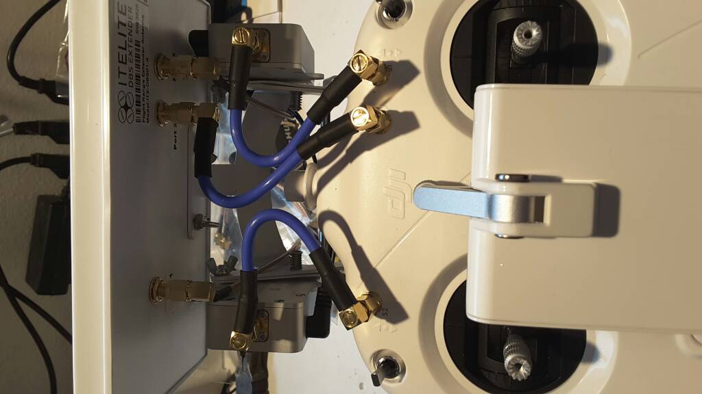

1 and 1 work great. Thought I've never tried 3 this works for me. Like you will add a 3rd if it becomes necessary but right now battery runs out before signal in the country.
