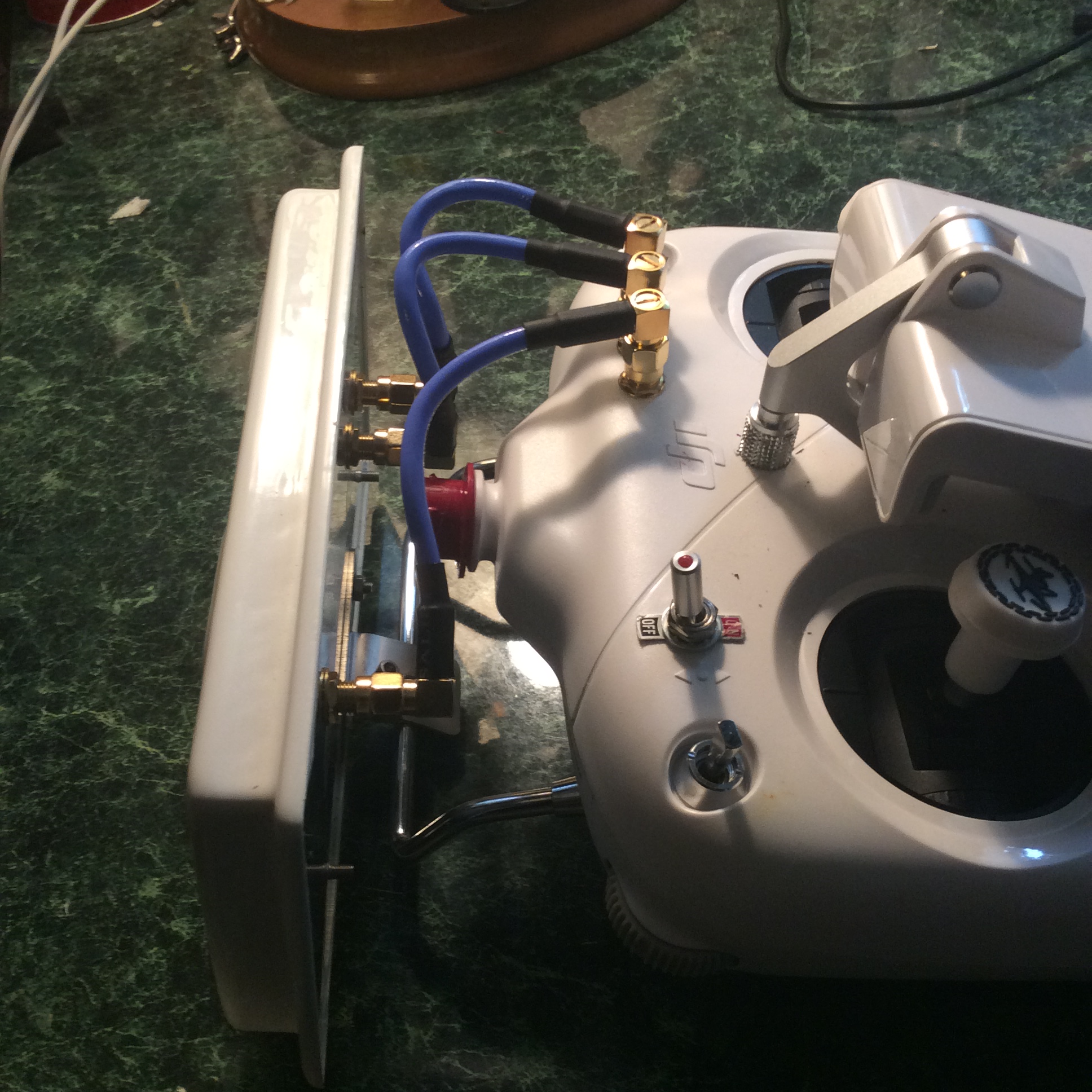

@dirkclod really enjoyed looking at your video wow you have gotten some distance great job on all.. I can maybe get 1600 feet with the DBS mod only because I'm in cogested Wi-Fi area park.but alot better then my original 800 feet
I tred going the cheap route putting 3 6 dbi antennas .. worked better but no comparison to my dbs mod wow great $130. .. only lil problem i ran into is i put one of my antennas wires were my old antenna was, so the hook up on dbs i lil close ... don't want to open the transmitter again but with your right angel blu wires that will solve my problem
Can u send me a link to the blue wires please thx
