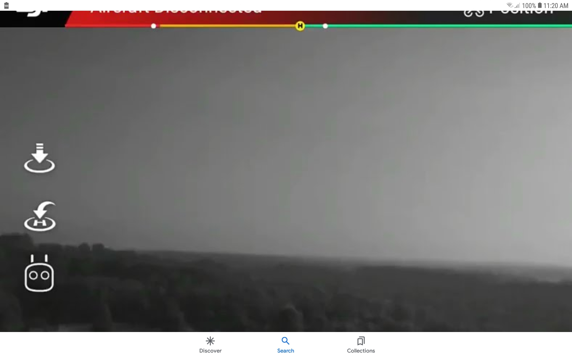

OK, the P3P is still on 1.11.20
RC is 1.9.2
Where can I find the old FW, at least up to 1.4
Those versions should be fine as they are years later than when the flight modes were introduced.
I also see in your photo that you are using app 3.1.68 which is also fine.
Have you checked the suggestion from @ianzone about checking to see if the "Multiple Flight Modes" setting is enabled in the app?
I haven't used that mode in years, but if I recall correctly I think you need to be connected to the AC to enable that setting.
Anyone please confirm or correct. Thanks.
Same question as earlier. Have you checked the suggestion from @ianzone about checking to see if the "Multiple Flight Modes" setting is enabled in the app? Click the link in this post or in my earlier post if you are not sure about that setting.
