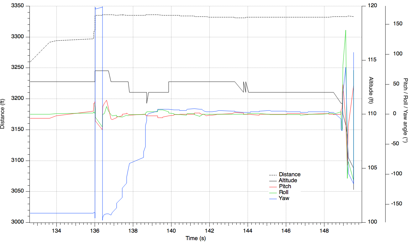

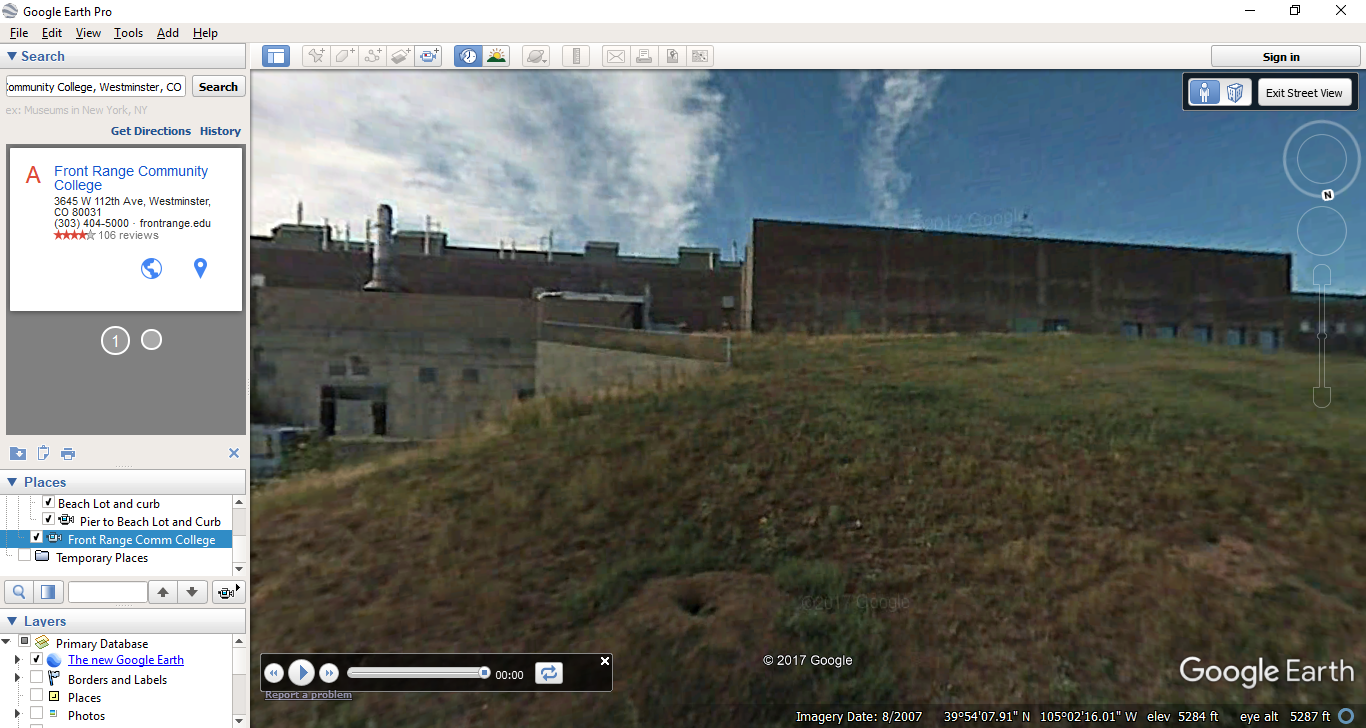

Looks like it hit the roof on Front line college. In google earth the college may be higher than the take off point and airdata says max alt was 115ft. So by the time it was passing "through" the college it may have hit the roof.
It went into ATTI mode at 12mph.

As noted above, you may have slammed into the college building which would explain the data coming to an abrupt halt. I think the MCDatFlight folder they are asking for is the .DAT file on the drone that needs to be recovered for analysis (a requirement when using Litchi).

The Pitch, Roll and Yaw data from your flight data confirm that the Phantom hit an obstacle and tumbled but probably didn't fall to the ground.
The take-home message about ensuring waypoints and RTH height are sufficiently high to clear any potential obstacles should be obvious.

I don’t think it did crash into that building, the reason is the last image I retrieved was it flying back.
It had turned around, directly over the building, but it lost a foot or two of altitude in the maneuver and it had only moved 3 feet back towards home when it hit 10 seconds later. I'm afraid that it is quite clear that it did hit the roof of the building.

2m 15.9s Waypoints 11satellites 113.0ft 20.7mph 3,301.7ft
2m 16.4s Waypoints 11satellites 114.0ft 2.9mph 3,339.6ft
In less than 1 second a screeching halt. Maximum distance 3341 feet. Then gradual acceleration and a few feet shorter distance, so it could have been headed back, however, it was also losing altitude.
I would look at the Litchi mission settings. Any chance you can share the mission? The settings changed to Atti? Does Litchi do that at the end of a mission?
The switch to ATTI was at 149.2 seconds, after impact.
