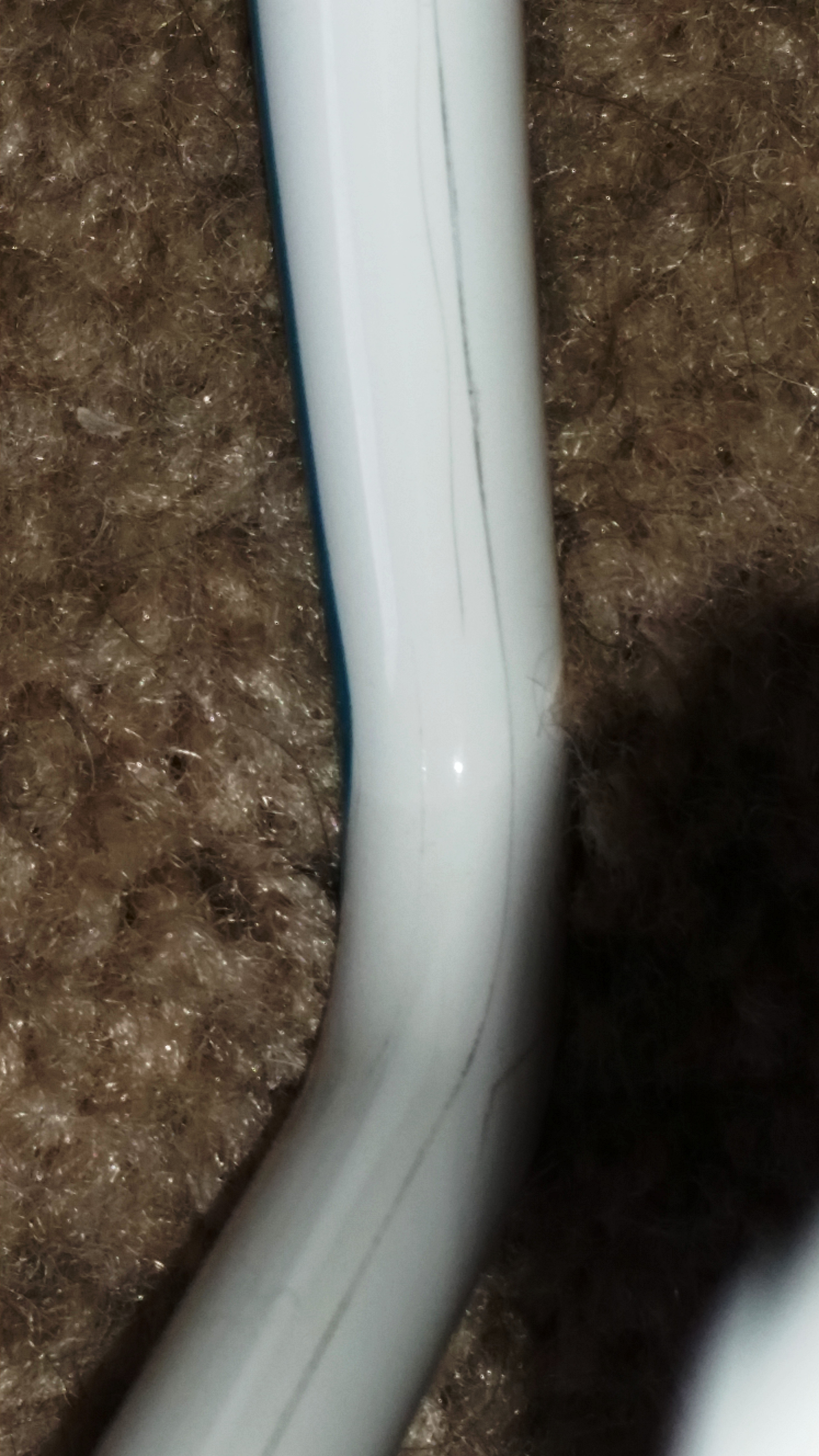

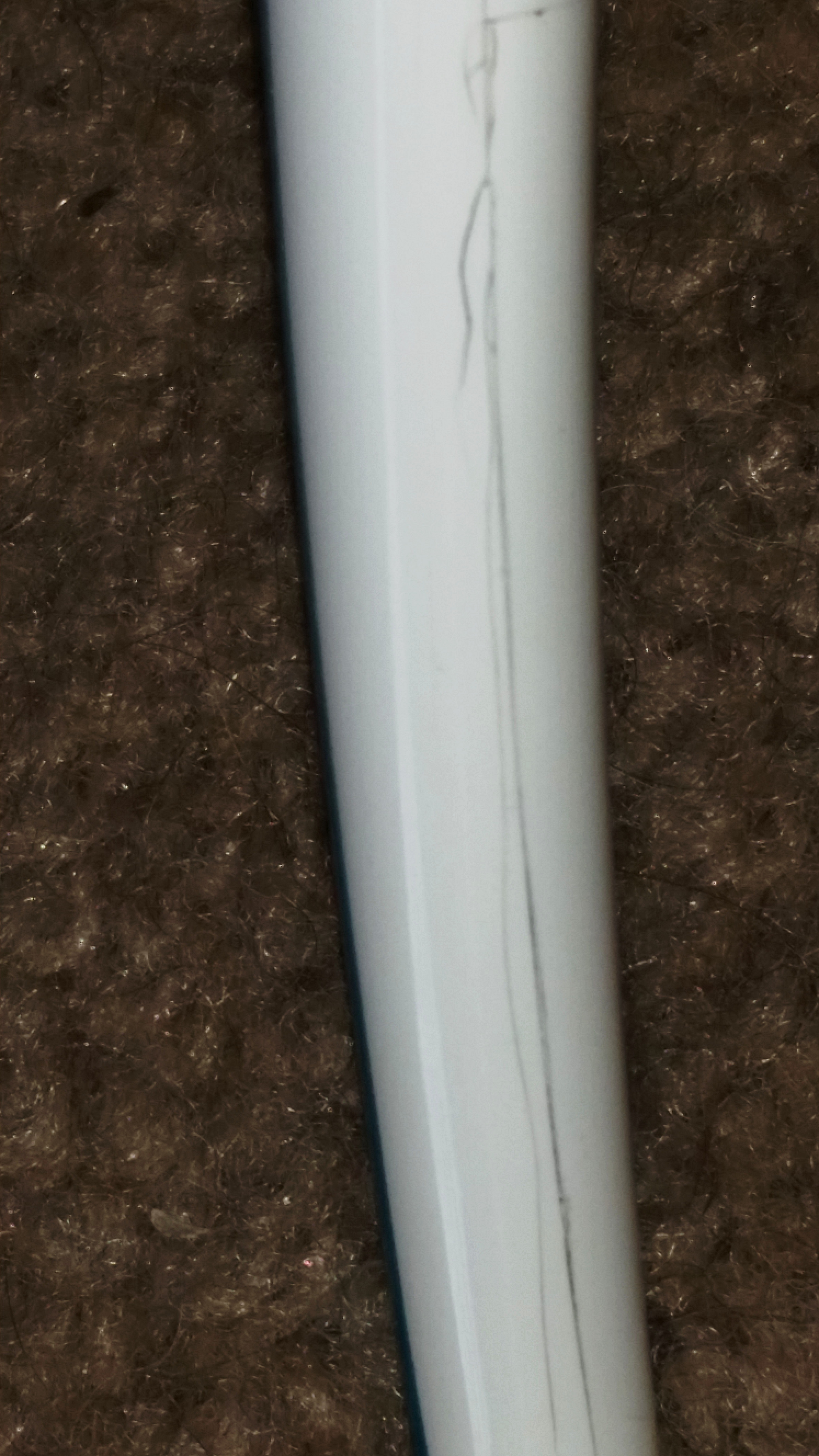

I just noticed the cracks on my Jan. 2017 P4P and ordered new landing gear prior to reading this thread. Will I have to purchase a lower shell and do the whole re-fit then?
Where exactly are the cracks? Got a photo?
The cracks are up and down the inside front and rear both sides. Also a couple of horizontal cracks. I'm not trying to get anything from anybody, since my warranty and care refresh are both expired at this point, I only want info to prepare me for this repair. So, believe me when I tell you no crashes and no hard landings. I have only landed this craft a handful of times since I mainly hand grab. If photos will help I'll make a few and post them. I tend to suspect that storing and transporting the P4P in the Ultimaxx pack that I got with it may have something to do with it since there is no structural protection and carrying a full pack of batteries, controller, ipad and a load of other accessories might create pressure on the shell and legs ultimately causing or at least contributing to the cracking. Thanks for your thoughts.
Reactions: Javier Ruiz O
Um I getting to that stage on p4 landing gear,still ok for now but is cracking alright,,
There was another thread on the issue of hand catching possibly causing stress cracks on the legs or where they attach due to unnatural torque applied to a leg when grabbed by just that leg.
Reactions: Rudder Bug
Here are a couple of my cracks. Maybe it is the hand catching, but the cracks are on both sets of legs and I only catch on the right side gear. Dont know. Does anybody know of a catastrophic failure due to these cracks? Maybe I'll try the plastic welding kit recommended elsewhere here for shell cracks and see what happens.
