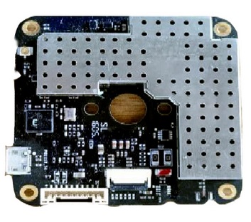

There are no se boards in the usual place. But searching google, you can find how the top board looks like.
On the image, I can see antenna connector in the top left. It's strange there's only one - typically you want to double the antennas to improve video feed range. But regardless - we've learned that the video transmission has its own transceiver, separate from the drone control signal.
Phantom 3 Pro and Advanced have no chance of being compatible then, as they connect to the separate OFDM board to transmit the signal.
For Ph3 Std - it has similar design to what we see here is SE. It is possible that it would work. But it is still unlikely:
* Power cable pinout would have to be matching, and DJI is known of having a different one in every model, even if there is no reason to break compatibility
* The radio transmission, and the ID transmitted there, would have to be recognized by the RC - I'd give it 50-50 chance that DJI changed something in the protocol, or at least changed the ID.
Good information there!
I tried similar with a Phantom 3 Standard camera and gimbal with my camera-less Phantom 3 SE and can report back that even though the power seems to work fine, there appears to be no way to get the controller to bind to the drone once the power is on on both so I suspect something like you say in the IDs is different
What I didn't try was to pair a Phantom 3 Standard controller with a Phantom 3 SE drone with a Phantom 3 Standard camera attached - I wonder if that would work?
