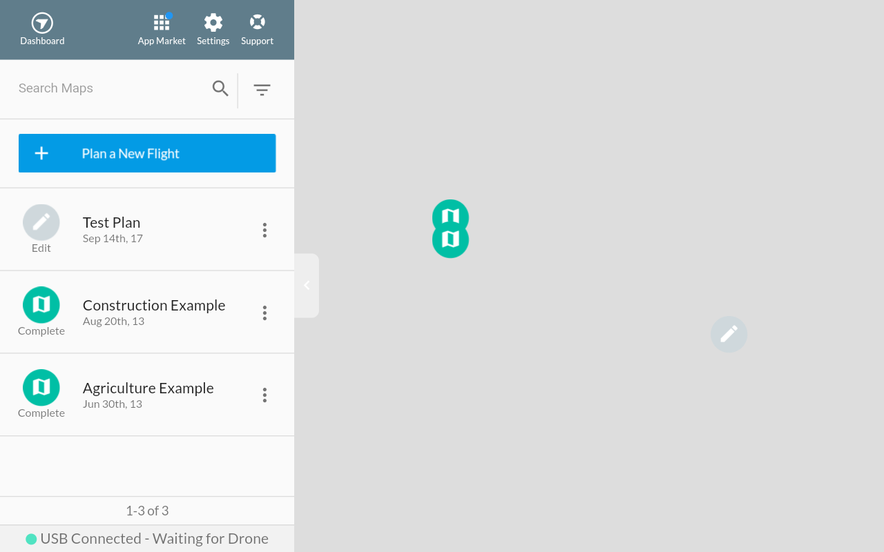

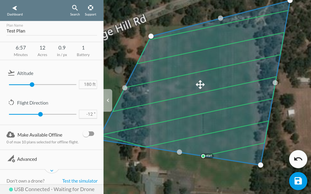

I still can't figure out how to upload the mission to my drone and make it do the mission.
See screen shots
Yeah your right it does. But it had a pop-up message saying it was connected.
Could you/someone post a picture of what the app looks like when a drone is connected? Also what you have to do to upload/start the mission.
