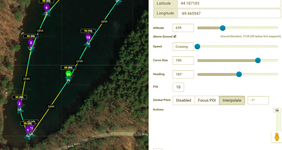

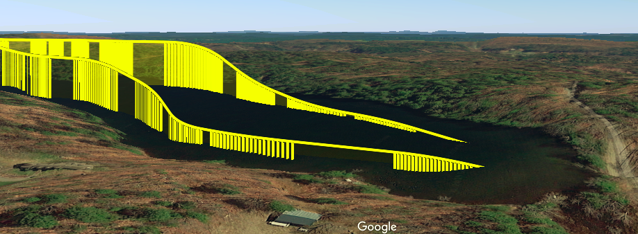

I've created a waypoint mission using Litchi. It's an overwater flight of a local freshwater pond. Litchi reports it's at 212 ft MSL. I've got the Above Ground and Use Online Elevation settings checked in Litchi. As I always do, I've exported the Litchi mission into a KML file to load into Google. The paths for the file enter the water in Google earth at the beginning and end of the flight even though the Litchi alt is set to 42'. What would the result of the flight be? Anyone? Screen shots attached:

Google Earth has 5 different ground references it can use. Make sure that the KML ground references are correct between GE and Litchi. You can read the KML file with any text reader.

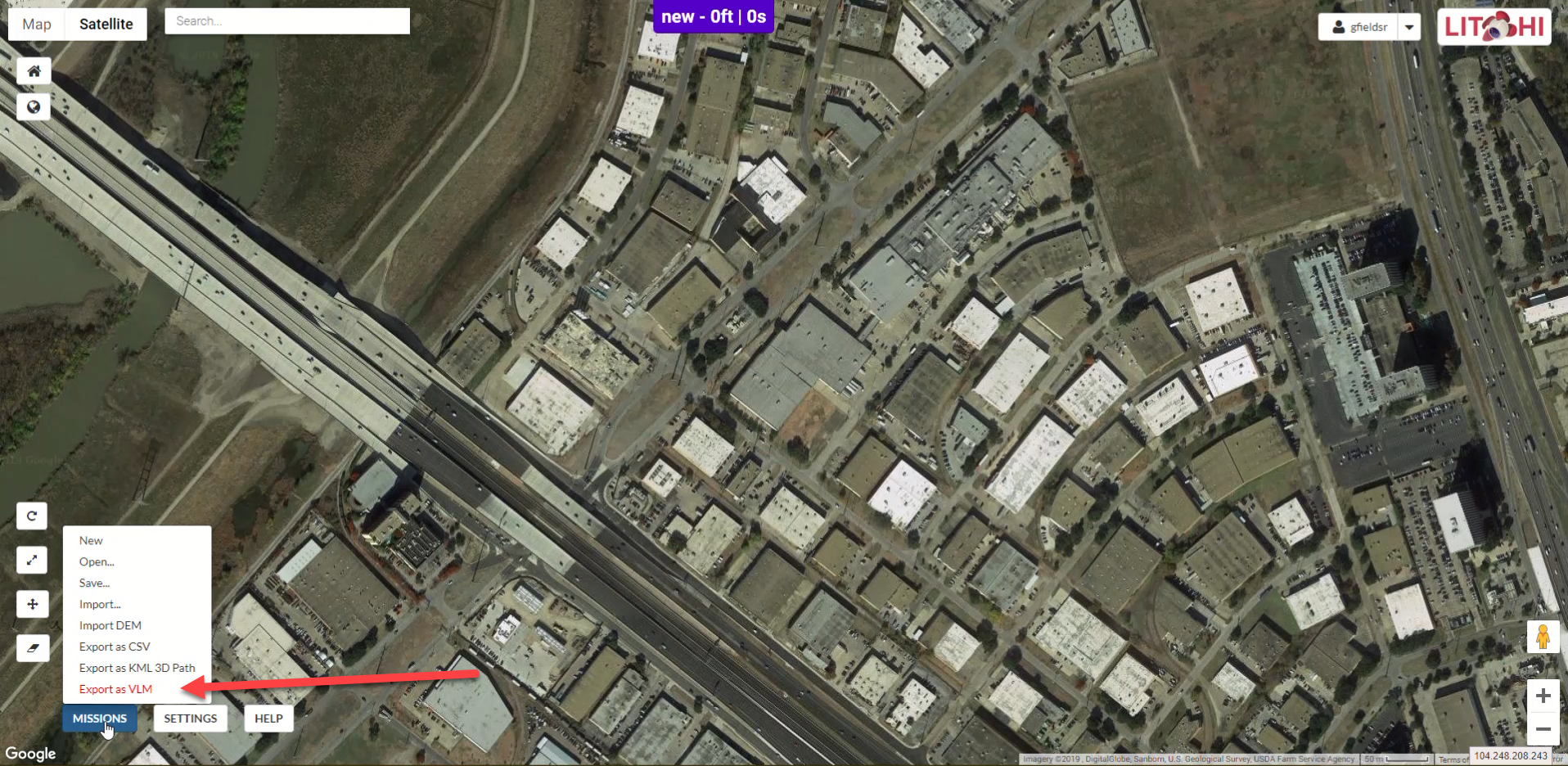

1. Download and install the Chrome Litchi Virtual Mission plugin
2. Open Mission Hub - Litchi using Chrome browser
3. Click on Missions and export as VLM
4. Click on the download and Google Earth will open.
You can even fly the Virtual Mission. You must first open or create a mission.

I did inlcude a screen shot of the Litchi mission where the altitudes were in question. You can see from the other image the problem was with wp 1 and wp 21 (start and end) where they appear to submerge into the pond. Nonetheless, I just took a dive into the Chrome extension for VLM and it solved my issues as it provides a far superior export set of data and graphs. Thanks for your help.
