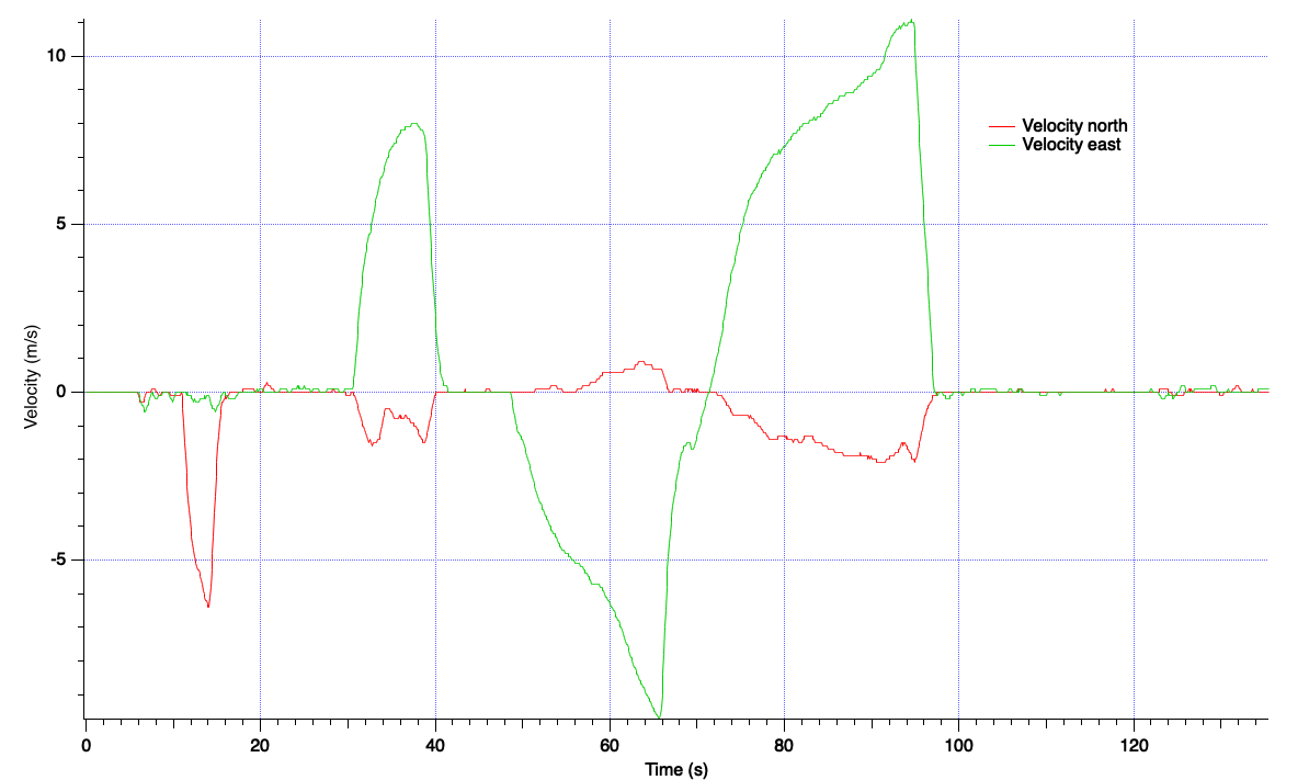

The more experienced log reading experts can probably contribute more than I can. I did not download the detailed flight log but what I see is that:
  • You took off with a battery that was not fully charged. It is good practice to start every flight with a battery that is fully charged. Anything less and you can find yourself in a situation where the battery gets critically low very quickly.
  • The speed readings look very strange. I see speeds near 250 MPH. Perhaps you have some issues with sensors on the drone.
  • You can see that very quickly into the flight, the variance between the battery cells starts getting larger. This could be because you started with a low charge or there may be an issue with the battery.
  • There is also a motor overload about 18 seconds into your flight. That could have been causing battery issues as well. It doesn't look like you were doing any violent maneuvers or high speeds at that point so perhaps there is a problem with one or more of your motors.
That's just my take from a quick look at the flight. I'm sure one of the log experts can shed way more light once they see the detailed logs.

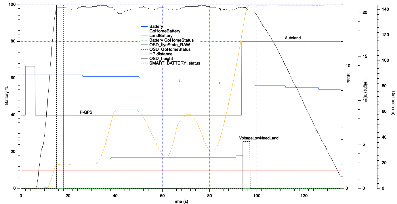

It was a low-voltage issue that triggered autoland, caused by starting with a low battery. Specifically the smart battery controller threw the quaintly-named "VoltageLowNeedLand" flag:
110307
Thanks! Your information is very clear. I promised myself that I would never start again with a half-full battery. No matter how tempting it is.
