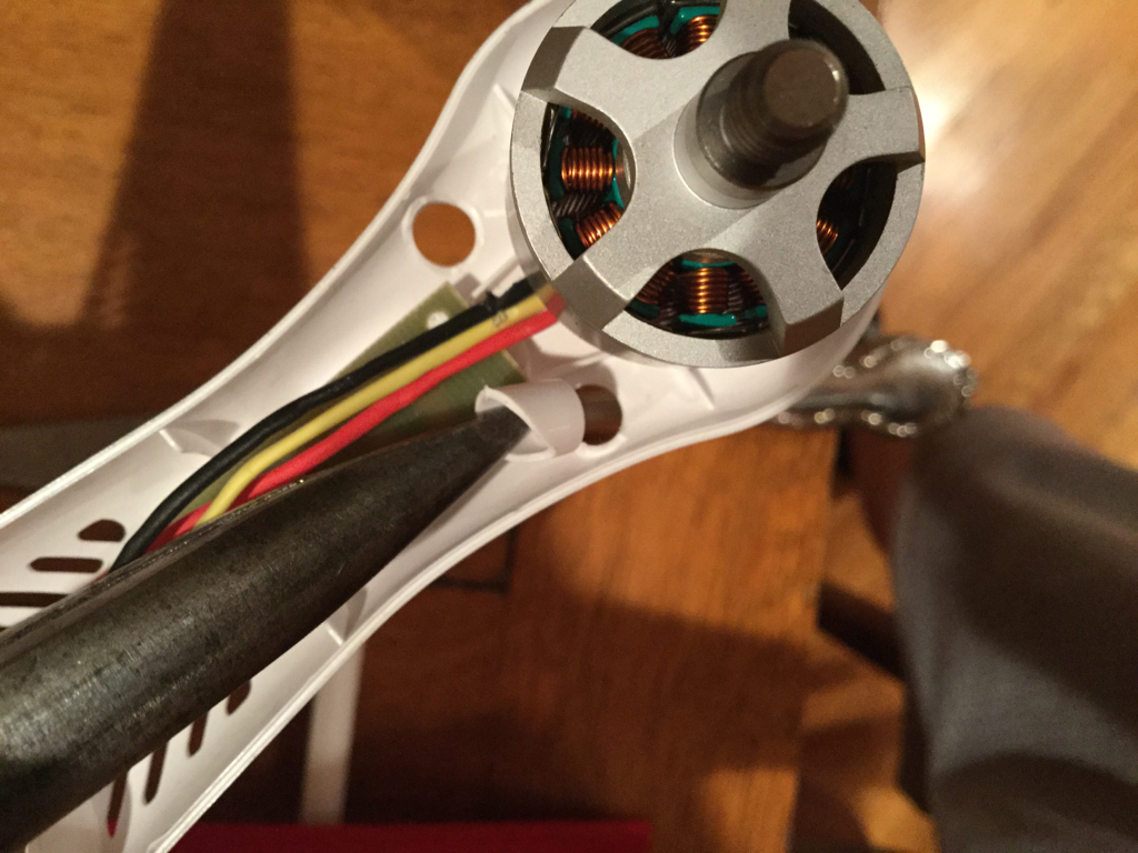

Thanks for responding. the motor mounts are fine, but I am currently removing the top casing to inspect the arm where the casing separated as there might be some damage there [emoji16], so I'll let you know, and I will do an IMU calibration. thanks for that suggestion.
Turns out the casing near two of the arms was lose, causing the motors to be loose, because the channel through which the screw go to clap the case together broke.
That's on two arms, so I'm going to glue them back, but I can't find one of the channels, so I'll probably glue down a small washer and then use that.
No, mine were looser, causing the phantom to shutter. I simply glued those three channels (one of which you see in the picture) back. I ended up finding the third one as well. I also had to glue some other cracks together. Interestingly, every crack was around a screw "channel" or around a nut embedded in the casing. I'm going to test it today. For you, just take off the top casing (Remember to undo the latches around where the two casings join as well. You might need a dull blade like a dinner knife.). This will allow you to look in since your stiff arm. Hopefully you'll see the problem! Let me know how it goes!
