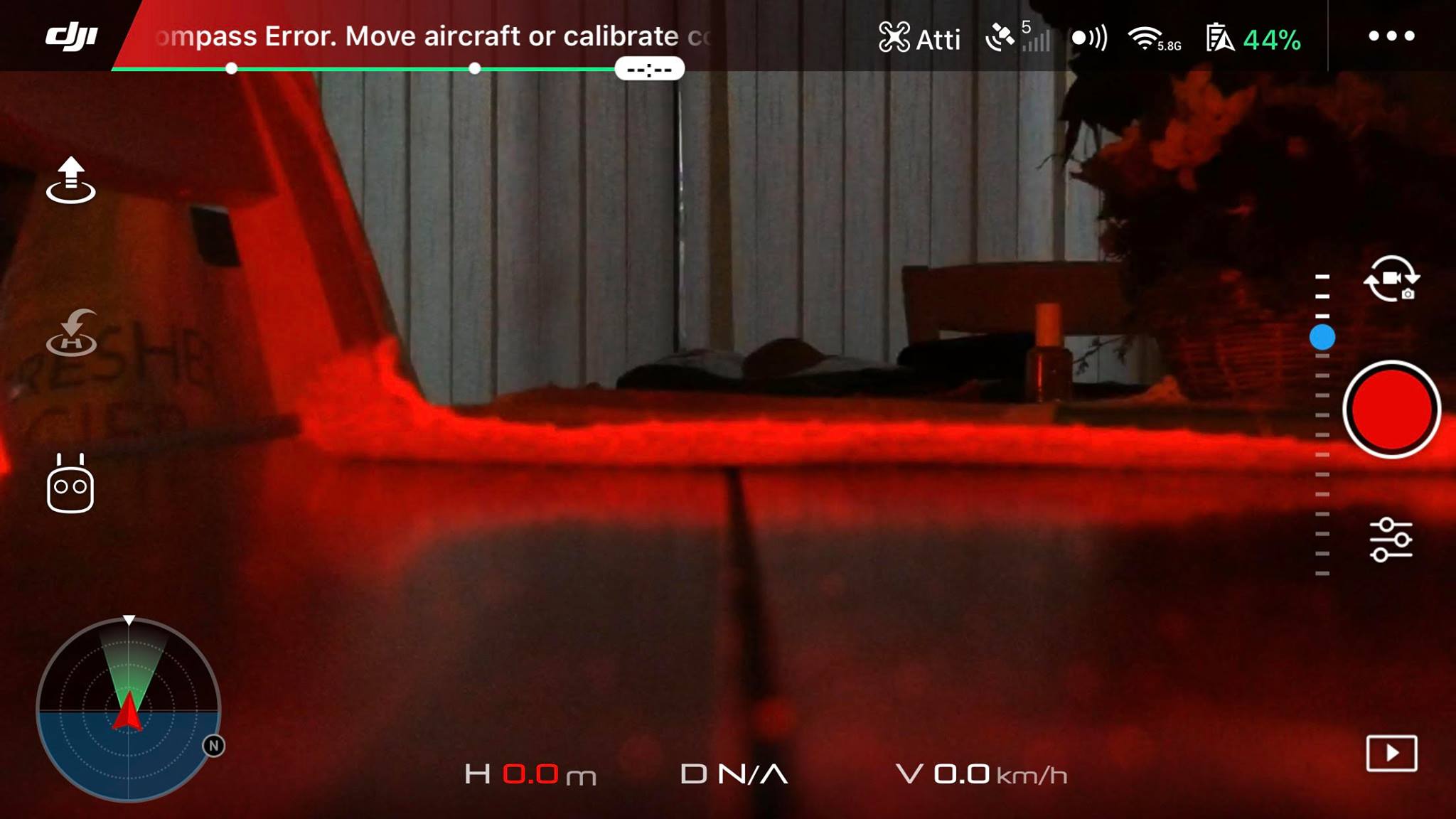

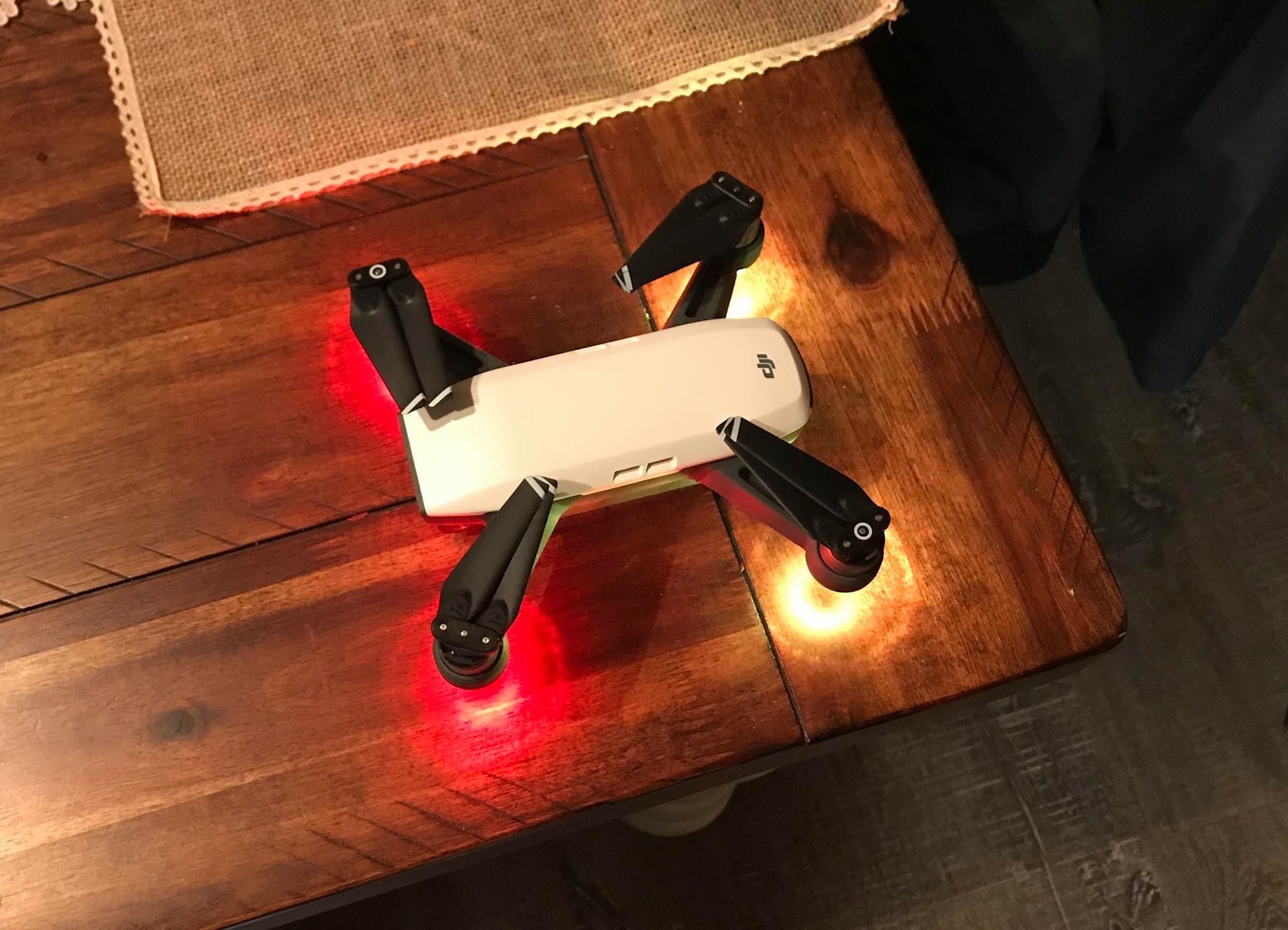

The picture I attached shows both the error and what’s causing the error on the spark. This is a wood table, what's causing the error are the two leg bolts underneath 4 inches of wood. Hopefully this shows how sensitive these things can be.

It was caused by a screw in the wood rail where the Spark was launched. But, here again, this wasn't caused by a flawed compass calibration, it was caused by launching from a geomagnetically distorted site.
