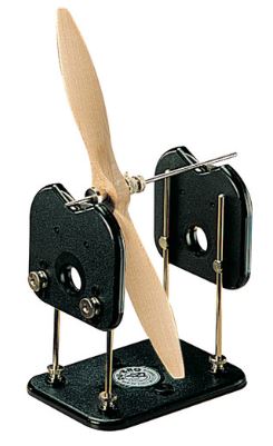

OkYou need a prop balancing thingy. I have this one:
Du-Bro Tru-Spin Prop Balancer DUB499 B&H Photo Video
I must admit that I haven't used mine since the P2 days though.

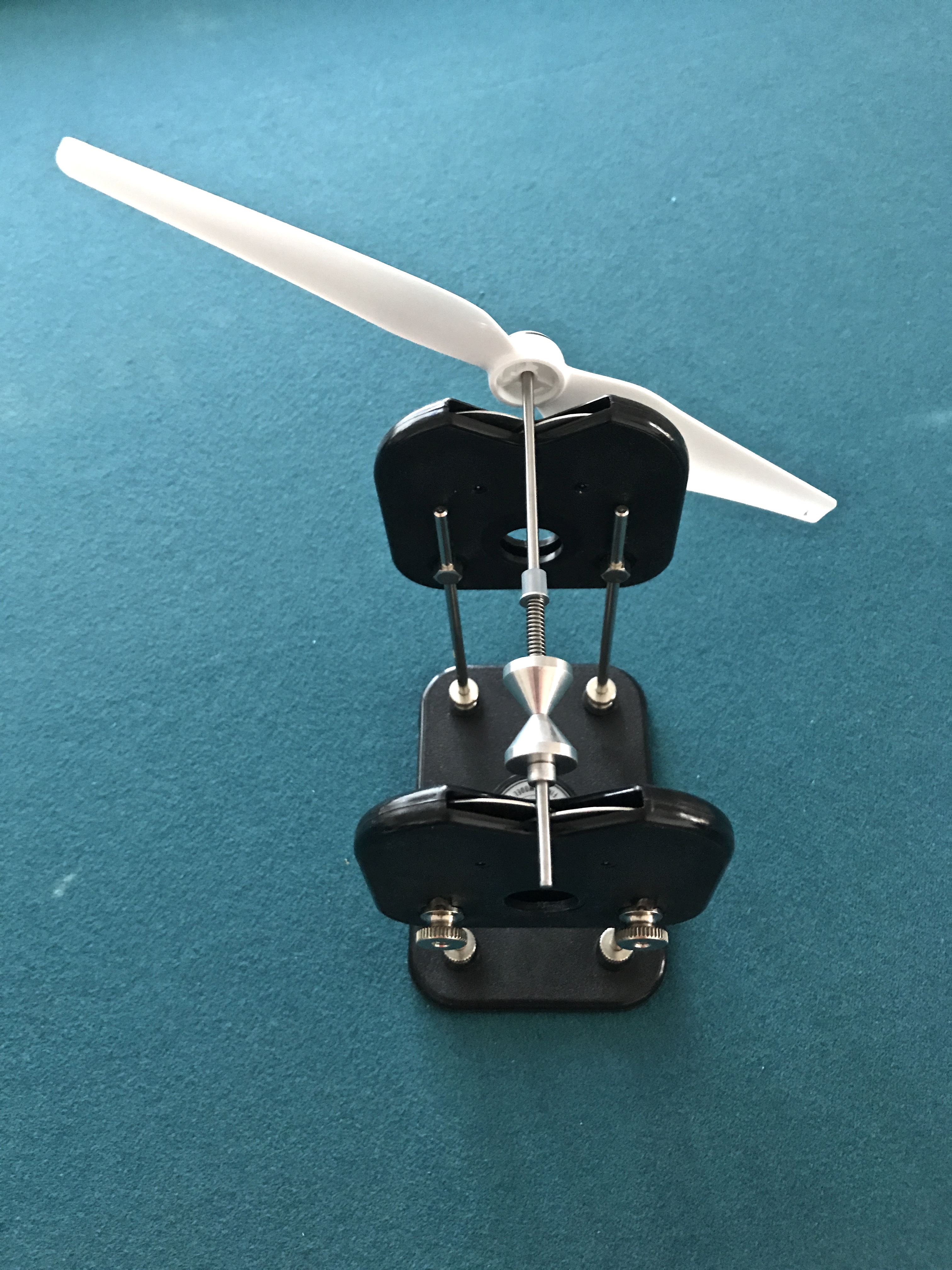

I hope you'll excuse the question, but how do you balance a Phantom 4 Pro Propeller with that device since there's no hole in the center of the P4Pro Propeller for the rod to go through?
