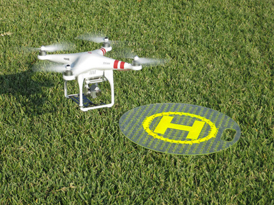

Hand catching is a very bad idea and should only be done in emergency situations, such as stopping it from flying into a bystander.
I have found two reasons for landing "flops".
One cause is ground-effect, which is common to all aircraft. The solution is to pause about 3 feet above the intended landing spot and descend slowly, optimally at a slight angle.
A second cause is from pulling both sticks to the center as in take off. Instead push just the left lever to the lower right corner and hold it there until the motors shut down. Then you can move the right lever to the lower left if you need to to complete the shut down.
A common door mat can be used as a landing pad, but I have found the HELIPAD from UAVBITS.NET solves several problems. It's more portable than a rug, the perforations in the deck seem to reduce ground effect turbulence/
reflections and the elevated platform provides protection from grass, sand and flying debris.
For more tips and useful information check out my Ebook on Amazon.com - Droner's Guide.
I use a black rubber door mat from Lowe's as a landing pad.
