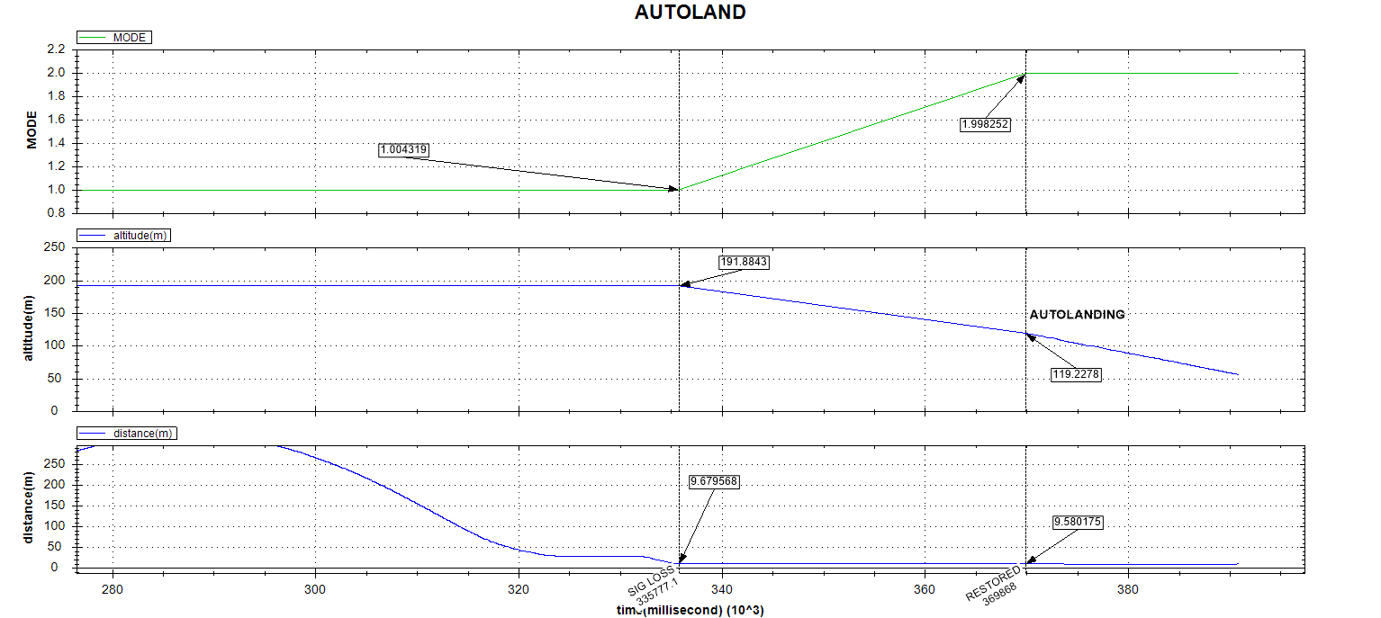

Hi, just lost my drone forever. I was using it for the past three years and honestly I never thought something like this could happen to me. However I have to admit that it is my fault. Here's the log from the Litchi app. My question to the experienced users is: Why Litchi decided that the drone will auto land after losing the signal? There was a message: Tap to stop AutoLanding but nothing happened after I was tapping it. And it didnt auto land. More like Auto fell from the sky.
Anybody have an idea?
Thanks, Emil
Go will do this as well. If you did not have your signal loss setting correct. There are a few other possibilities, however we need to see the full logs for that. Either share your Airdata file, or upload the .txt log file to here: Log Viewer
and share a link back here and we can tell you.
Or...the Csv File, in addendum to the above.

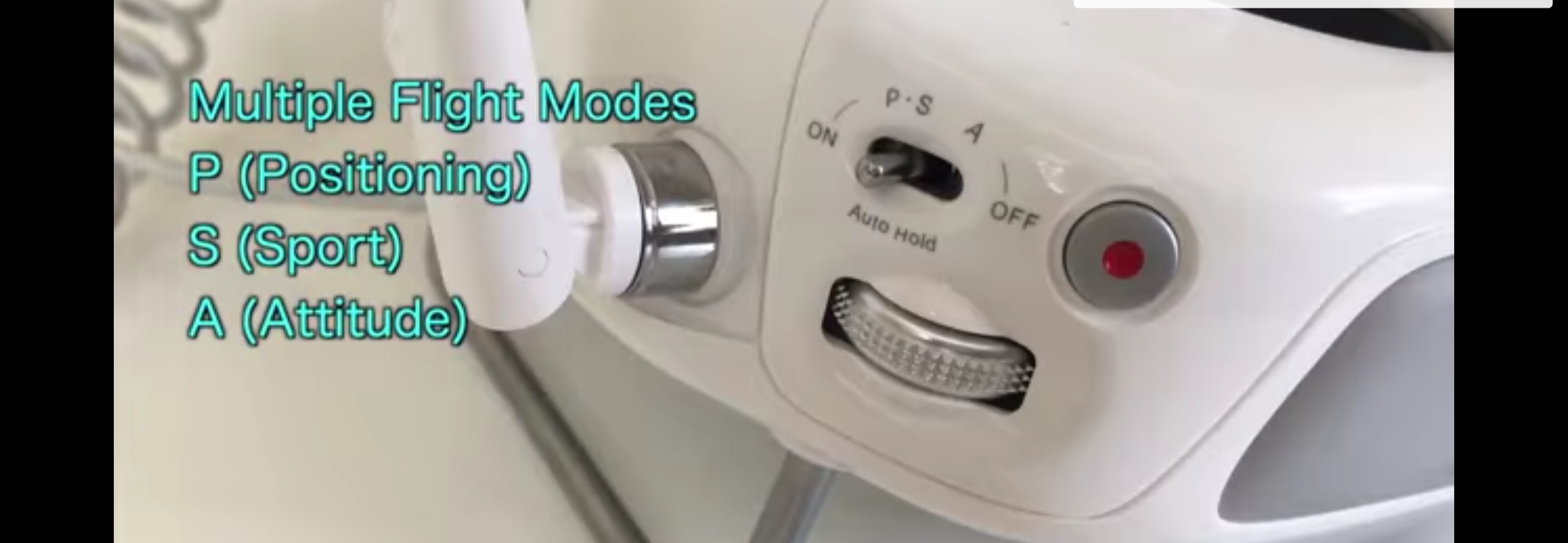

Hello, as long as the drone tries to do something unknown in P mode, a fly away for example, you must pass the switch to S mode and then return to P mode, with this you can regain control of the drone and cancel the auto-landing.
To answer this question, when complete signal loss occurs RTH will initiate within 2 seconds. In your case, the aircraft was too close to the home point so the aircraft lands where it is.
