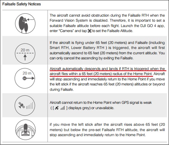

So i was this weekend flying when i push H button in the controller and it started landing instead of coming Home! Of course i have it marked correctly in the DJI App. So i tried again and through the app as well and again it started lading... DJI is having lots of issues lately right? (i did not update to last firm´)
Never knew that - thanks!
It's covered in the Phantom manual (along with some other important scenarios):
Double check your RTH preferences under the settings menu too. There are options for it to land straight away underground certain conditions
