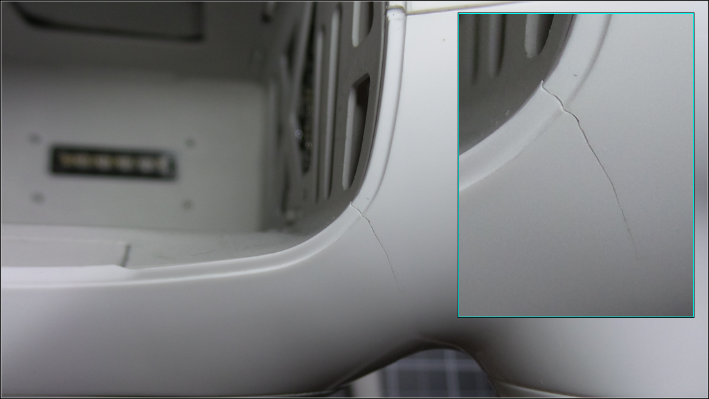

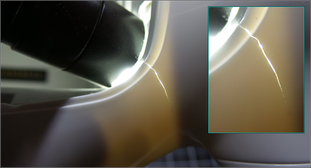

Found Another Crack @115.5hrs..
Jul 31, 2016
200
32
123
0.591088°, -90.750456°
...Found Another Crack @115.5hrs.., emanating from battery bay, right-side, almost the exact same spot as
left side, I now believe this to be a weakness in the structural design rather than a defect in the plastic...
IIIDaemon
www.GasRecovery.net
I'd drill a tiny hole at the end of the crack to avoid its "spread." Then I'd carefully fill the hole and crack with a marine product called "Marine-Tex" (white). Expensive, but you can buy a small package for less than 20 bucks. Use care inside battery compartment to remove any excess to ensure later proper battery fit. All this may work for you unless you go for warranty repair, I suppose.
Reactions: d4niven
WOW... and I thought DJI had this problem worked out on the P4!
GEEZ.... will they ever get this problem sorted out???
Sorry to hear of your problem though and I hope you get the spread of the crack fixed!
IIIDaemon
www.GasRecovery.net

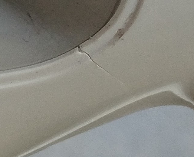

I have the same crack in my Phantom 4, but is smaller of this. My drone is perfect in all other parts and have not crash or hard landings. So I sure is a weakness in the structural design. My Phantom 4 has 3 month and fly very fine.
IIIDaemon
www.GasRecovery.net
...Ive already taken care of both cracks, '..to each 'is own..' but I don't think drilling a hole in this case, with this plastic, in this area, would be a good idea.. also am familiar with MarineTex, used it many moons ago (80's), great product.. no way i'd send my drone to DJi for Repair/Replacement again '..to each 'is own..' also all 3 of my batteries have heat-stress crack(s) at/near the indicators...
IIIDaemon
www.GasRecovery.net
