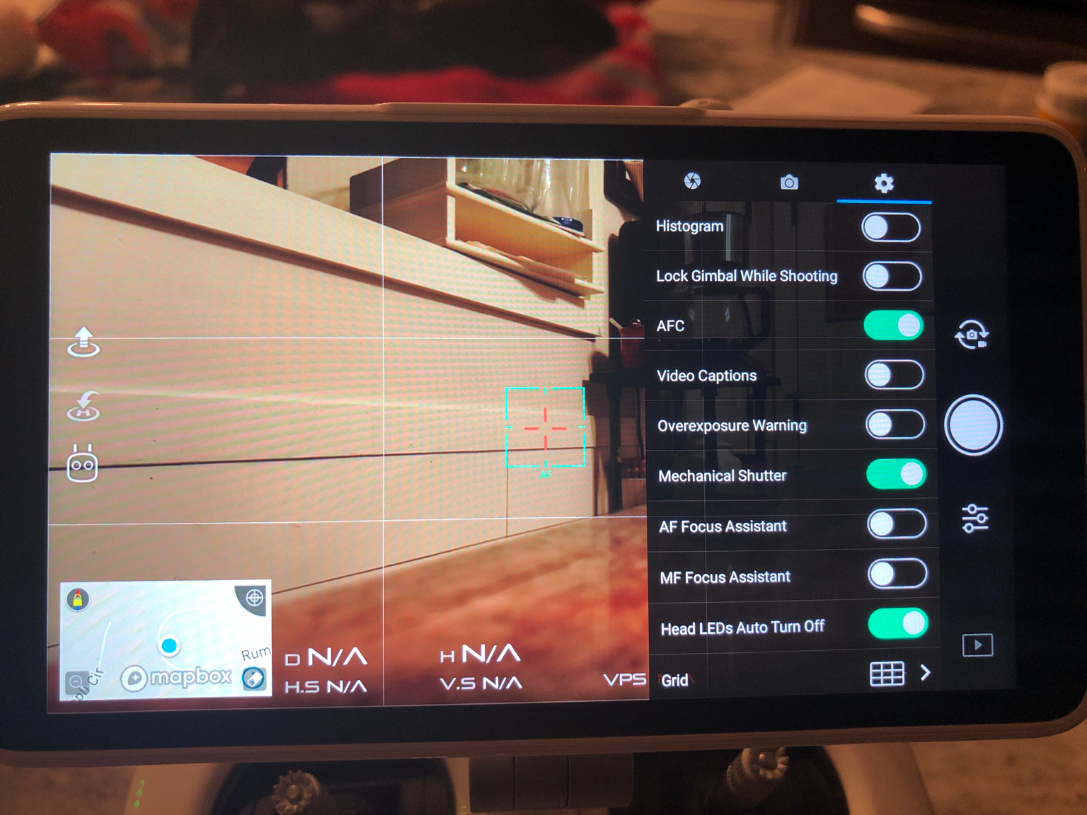

How about a screen shot to show what you have there?
Heres a screenshot of the camera settings I have applied. The problem isn't the volume being turned down, because I can hear noises like the autofocus indicator. The format SD card option within the camera menu does work. However the format SD card option found within the drop-down menu (if you click the bar at the top of the screen) does not work. It doesn't even detect the card.
My next option is to re-install all the firmware, but I don't think I'll have luck with that.
View attachment 109176 Heres a screenshot of the camera settings I have applied. The problem isn't the volume being turned down, because I can hear noises like the autofocus indicator. The format SD card option within the camera menu does work. However the format SD card option found within the drop-down menu (if you click the bar at the top of the screen) does not work. It doesn't even detect the card.
