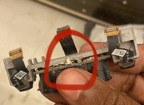

Battery switch mounted on ultrasonic sensor board . U can jumper it and use it . Sharing pic for reference
