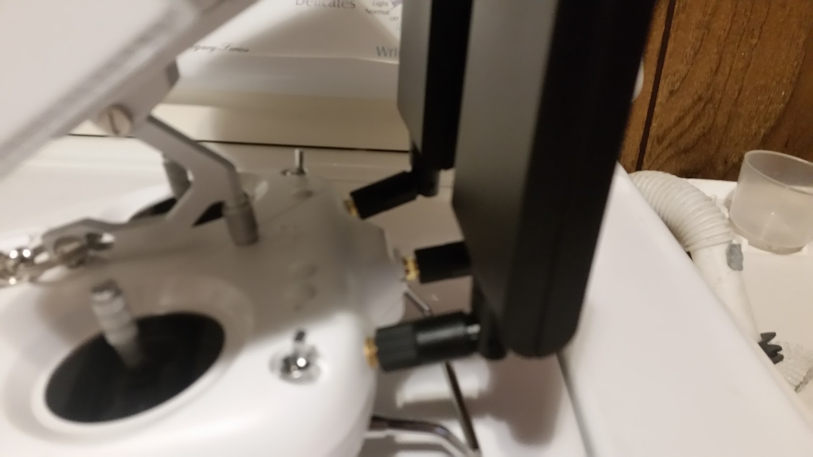

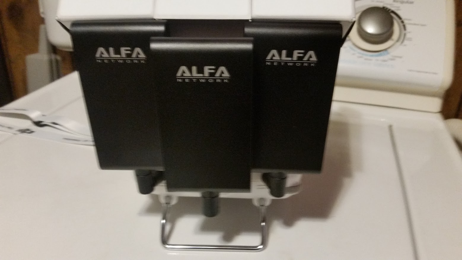

Just received my Alfa panels in the mail after work. I'm extremely impressed. I went with 3 of the APA-M25. I ran back to back vs. my DBS / ITELITE.
Things I noticed.... I could be a little more "sloppy" with my aim. You still have to point them at the bird, but you can move a little and it doesn't affect signal much. With the DBS, move a smidge and go from 4 bars to zero in a second. Video was smoother/less laggy. Even at only 1500 feet.

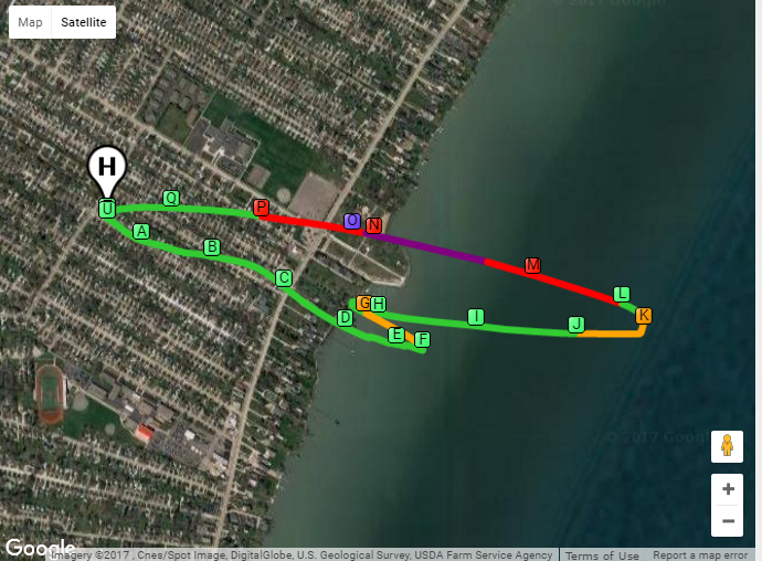

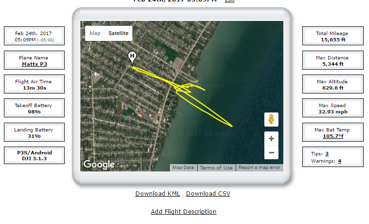

Ok. This run was with the DBS. This was as far as I could push it. Notice the signal map (picture 2).

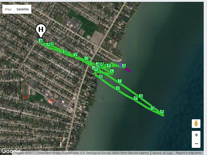

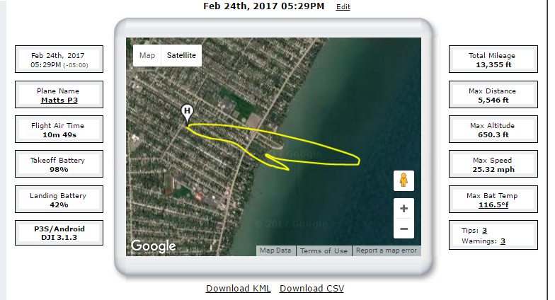

Now this is the triple Afla panels. I did the same distance as the DBS, but check out the signal strength even way out there. It's green the whole time. I know I could have easily kept going. And like I said... I didn't have to aim so much.
