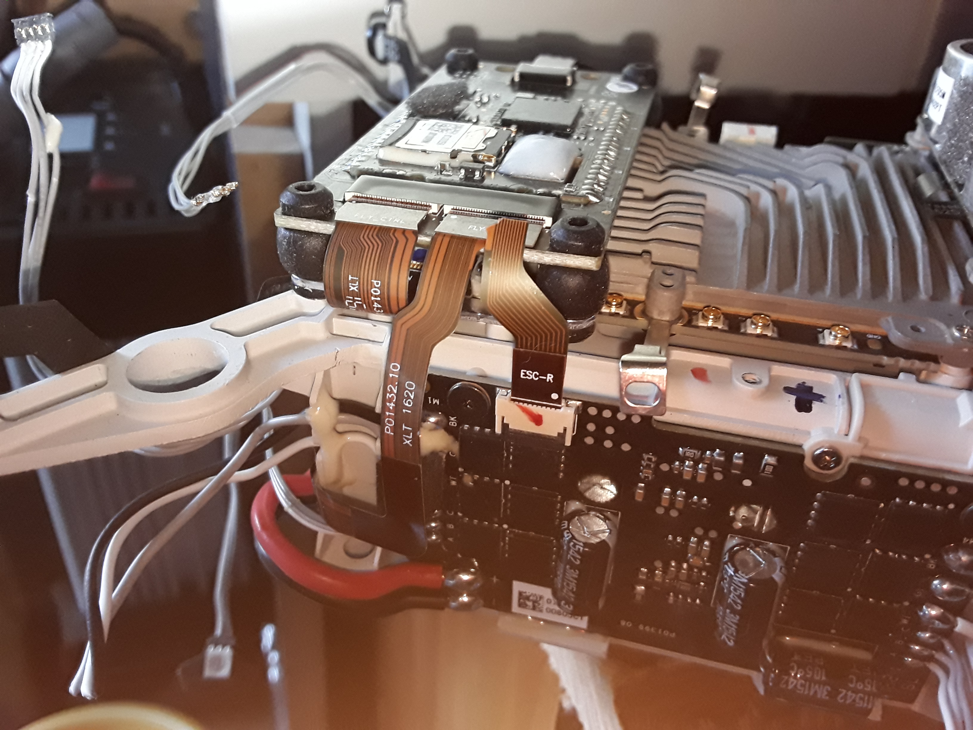

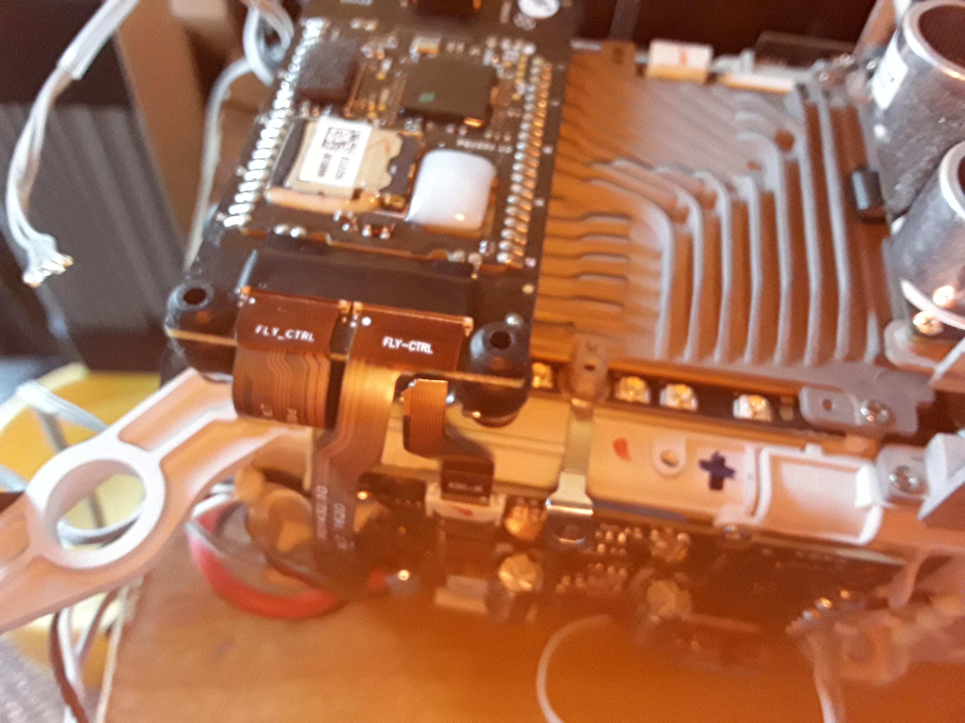

Is that one motor turn nice and feel like others,,esc (electronic speed control) causes this action,,you could try imu calibration,,,I know this symptom cause my p4 done it after free fall,,inside is a esc ribbon cable which was torn from impact,,see this pic ,ribbon say esc-r....the esc boards incisive have rubbers like gimble,,if they extend from shock to far they will tear as can see in my poor p4

Is that one motor turn nice and feel like others,,esc (electronic speed control) causes this action,,you could try imu calibration,,,I know this symptom cause my p4 done it after free fall,,inside is a esc ribbon cable which was torn from impact,,see this pic ,ribbon say esc-r....the esc boards incisive have rubbers like gimble,,if they extend from shock to far they will tear as can see in my poor p4View attachment 110176View attachment 110175
