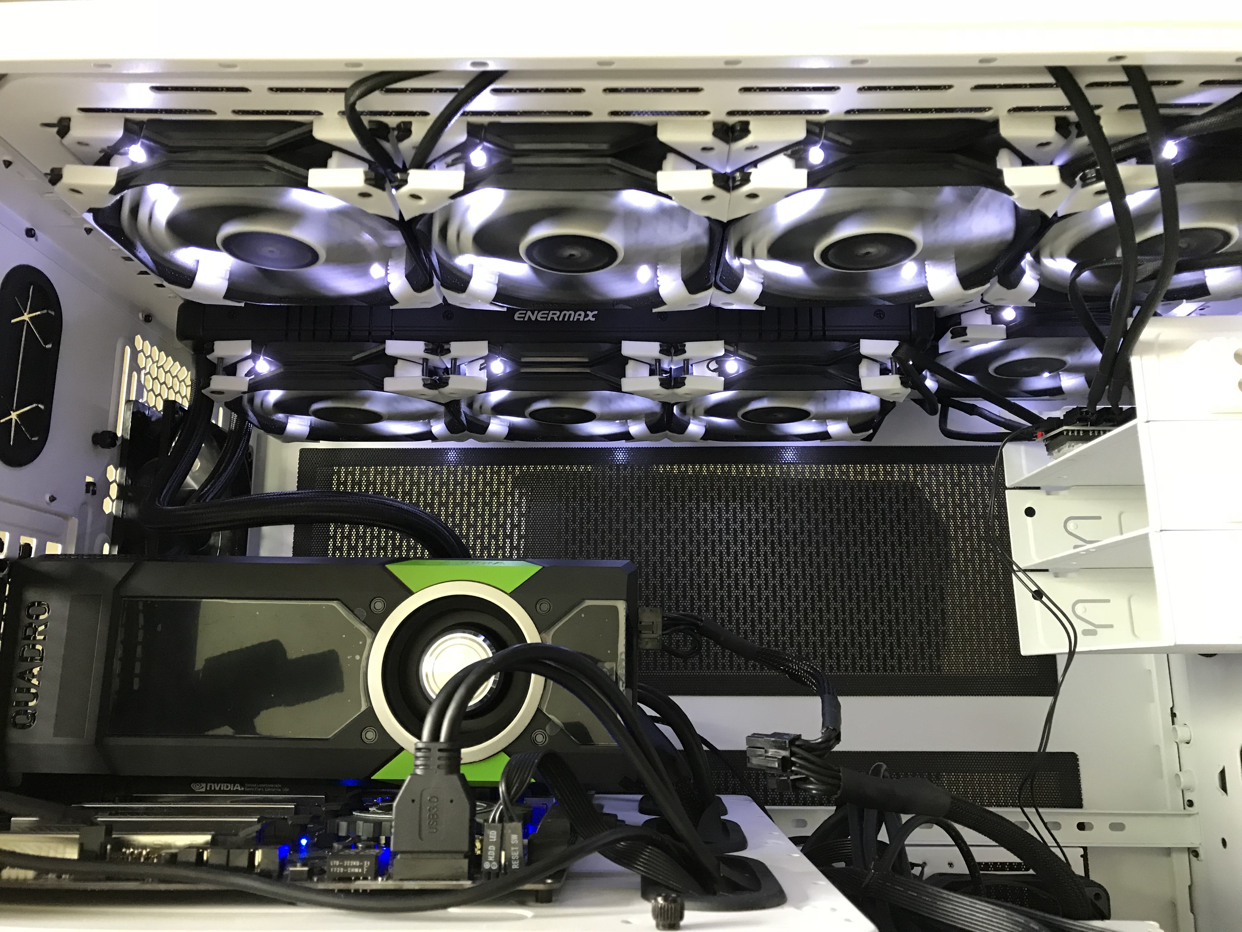

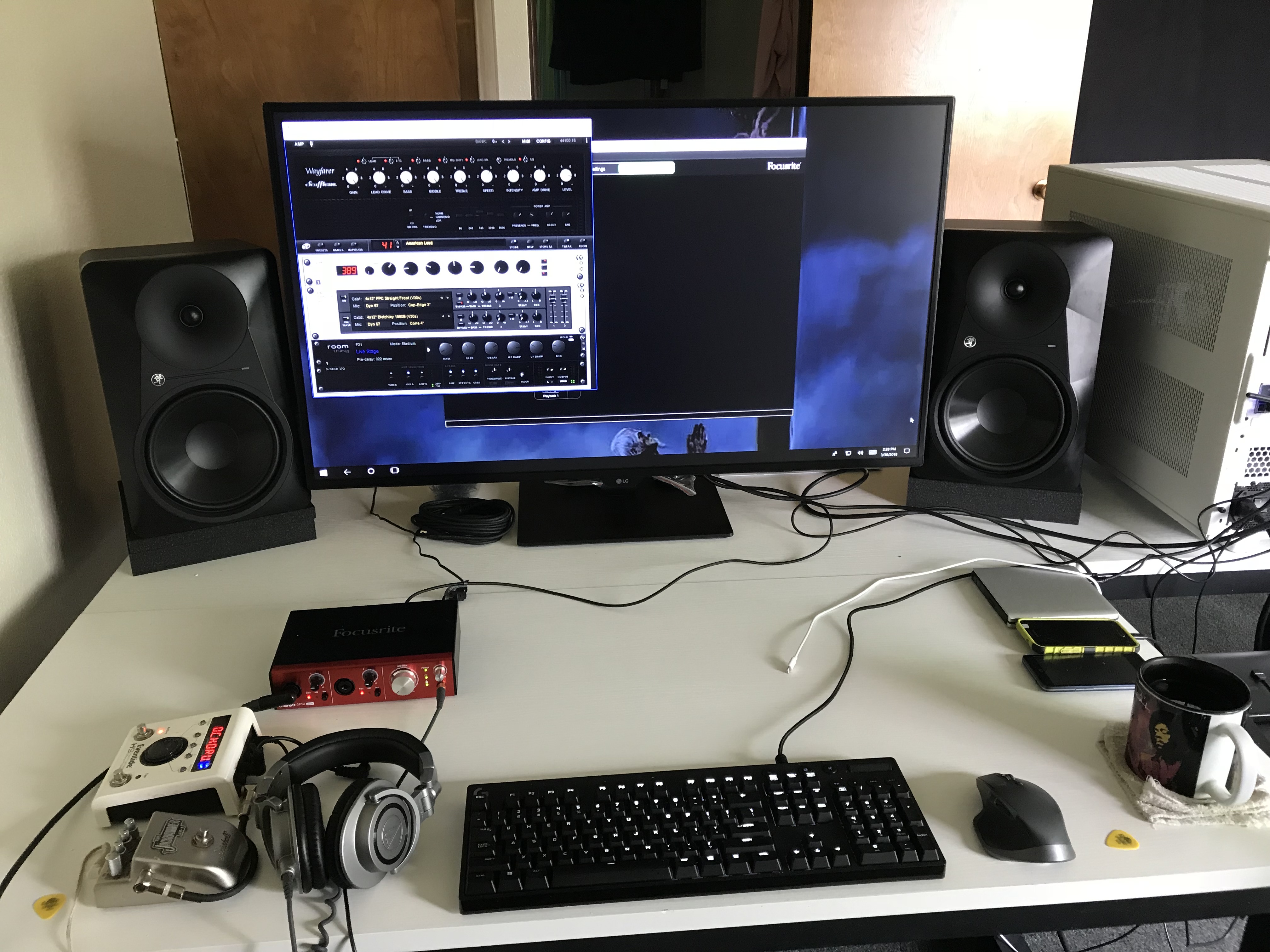

Davinci Resolve BMD Bete 2
CPU: Ryzen Threadripper 1950X 16 Core
GPU: nVidia Quadro P5000 16Gb
RAM: 64Gb G. Skill Trident Z 3600Mhz
Boot Drive: Sumsung Pro 960 2TB
Monitor: LG 42.5" 4K Display
Reactions: Oso
