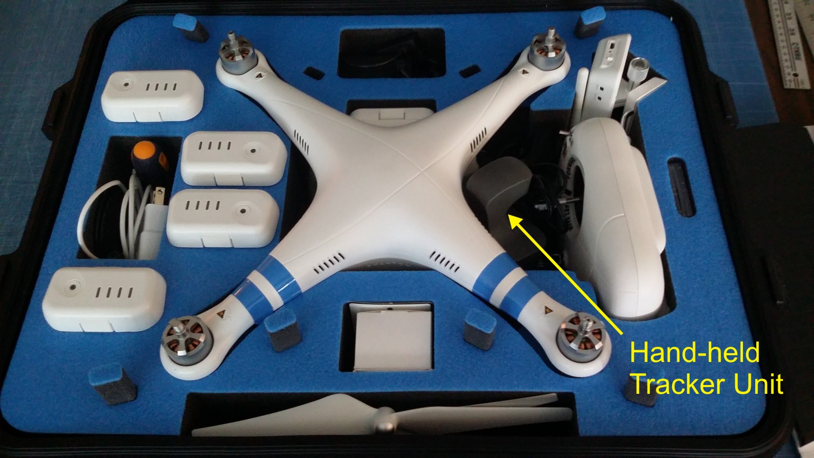

For those considering a Marco Polo tracker.. It took a while to figure out where to place the tag as I didn't want it to obstruct any Phantom air vents and I also wanted to insure, as best as possible, that the tag antenna orientation wouldn't wind up horizontal if the bird is lost. (Some signal strength may be compromised if horizontal at ground level.) Mounting the tag at the top of a front leg away from the main antenna and the compass (just as a precaution) seems to work well. In that location, the antenna will be vertical regardless if the bird auto lands on its feet or is belly up. And if it is tipped onto any two prop arms, the antenna will wind up at about a 45 degree angle and not horizontal. Naturally, no telling the orientation if it comes down in a tree or brush. And I was really happy to discover that the hand-held tracking unit stores nicely between the RC and Phantom in my case. I pray I never have to actually use it -- but with no monthly cell service charge (I don't get to fly very often) I'll be happy if it just sits there until I transfer it to my next bird.
