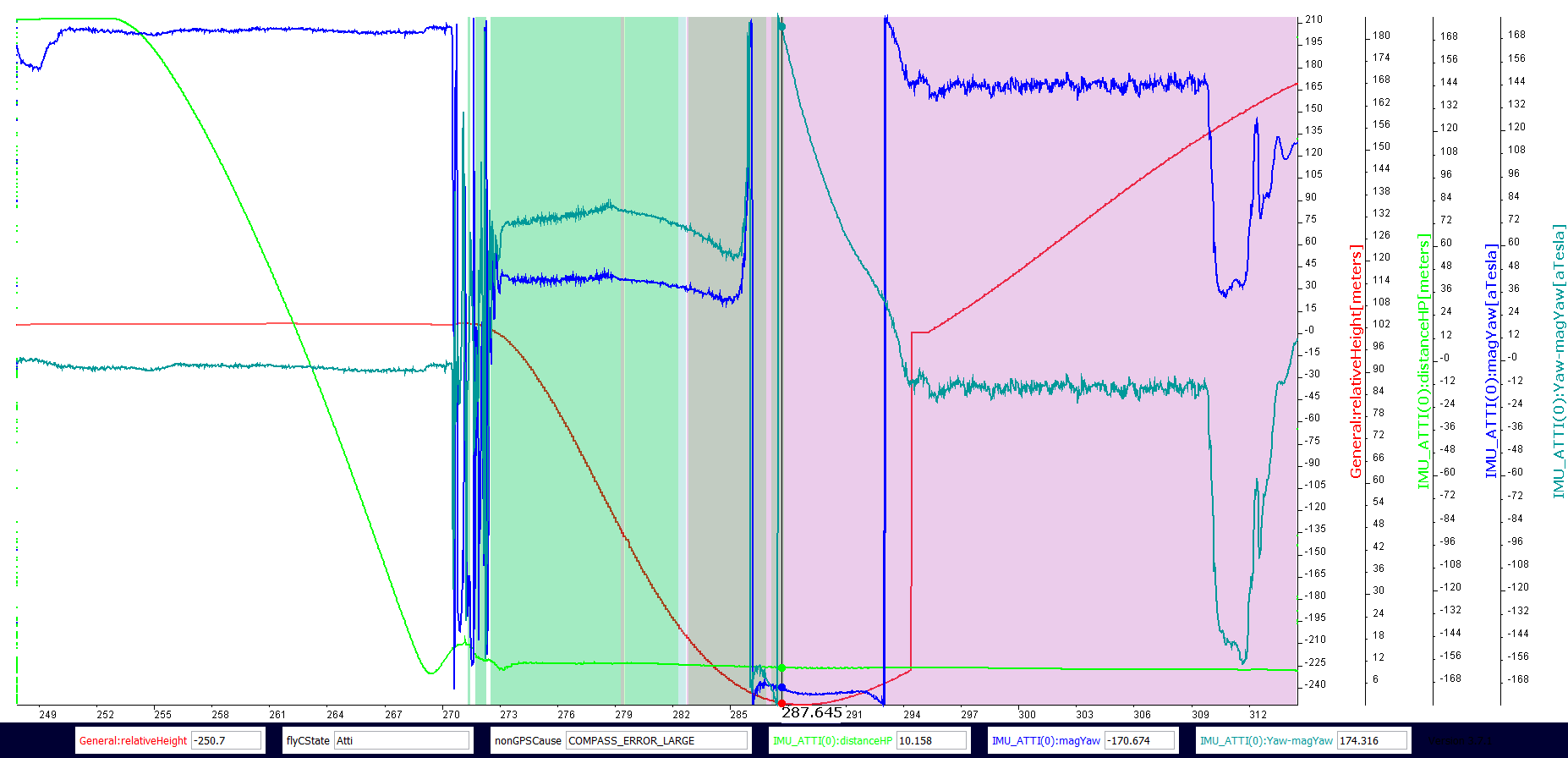

hello there..
i really need some assistance here as a sudden speed error occured.. dont know what happened.. i was watching that it was coming veeery slow back to me so i gave a bit more acceleration.. no wind at all.. when it was close enough to me i left the stick.. but it continued till it hit a wall.. there was no interference there.. and i really cant understand why it didnt stop.. it had plenty of space..
here is the .dat file of that flight.. really need to understand what the speed error stands for before any flight takes place again..
thanks in advance

@xrider You experienced a compass error. Usually this occurs in a magnetically distorted area and/or the launch point.

ive triple checked that place.. there was nothing.. no errors on start up.. no errors mid flight.. that thing has happened when it was coming back to me.. well.. it seem that it needs a good compass calibration..
what about the escs?? do they seem okay?? really dont know why it didnt gave the error in time but gave it after the crash..
@xrider The Esc's have nothing to do with the compass issue. Can you provide the .txt log for comparison with the .dat?

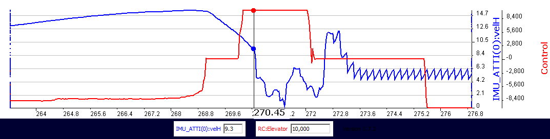

Looks to me like the P3AP was travelling too fast and couldn't stop before hitting the wall. The impact was at 270.442 secs. The magYaw and ESC issues occurred after the impact.
The P3AP was moving at 15.3 m/s (34 mph) when the elevator was released at 269 secs. The velocity had slowed to 9.5 m/s when the impact occurred. In this interval the P3AP traveled about 18 meters. That seems like a lot. Have you checked the gains?

The drone doesn't stop immediately. By the time you let go of the throttle it was going 34 mph (49 feet per second). When you let up on the throttle it did begin slowing down but the deceleration wasn't fast enough to prevent it from impacting the wall. From the time you let up on the throttle to impact was about 2 seconds, not enough time to get it stopped from 34 mph. When it hit the wall it was still going about 20 mph (20 mph is about 20 feet per second).
Someone that knows more about the drone can maybe comment on the maximum braking action and what is a reasonable braking distance when you are going that fast.
