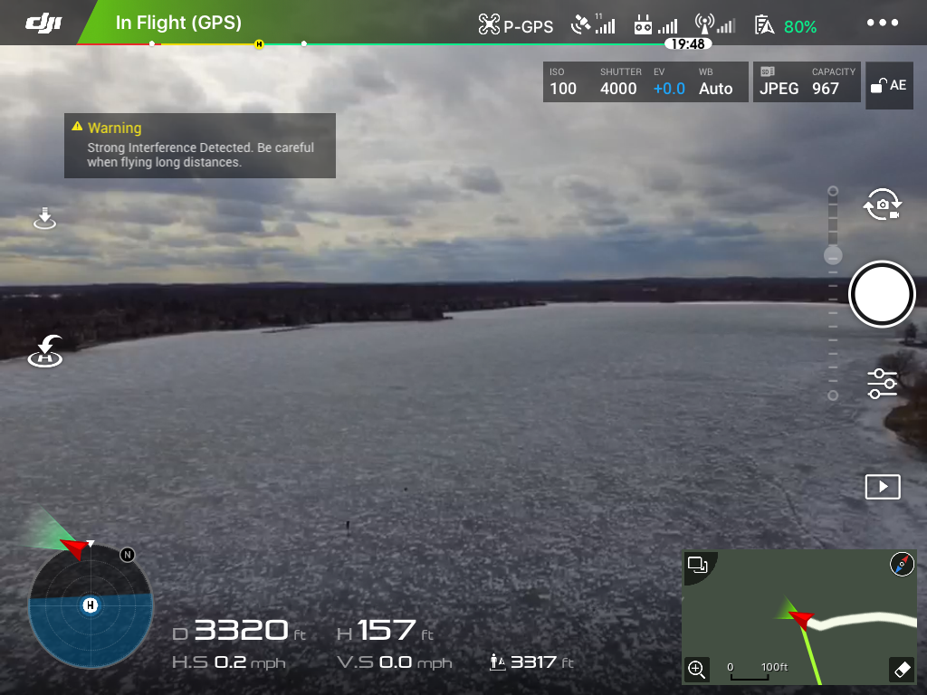

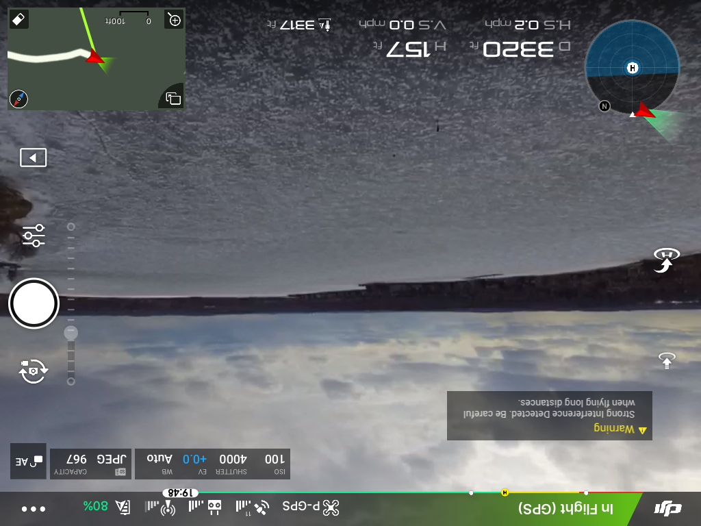

I watched a YouTube video on getting a stronger video feed and one thing that was talked about was making sure your phone/tablet is positioned correctly in the holder.
He said that the home button should always be on the left hand side when in the cradle. I had placing my tablet with the home button on the right and I was getting out around 1,700 - 2,200ft before I would lose the video feed.
For the heck of it I switched my tablet around and gave it a test flight and wouldn’t you know that I was still getting a video feed a little past 3,000 ft. I don’t have any idea why or how this makes a difference but wanted to share this in case it makes a difference for you.
I was flying my
Phantom 3 Std with the stock antenna.
Here is a screenshot at 3,300 feet.
