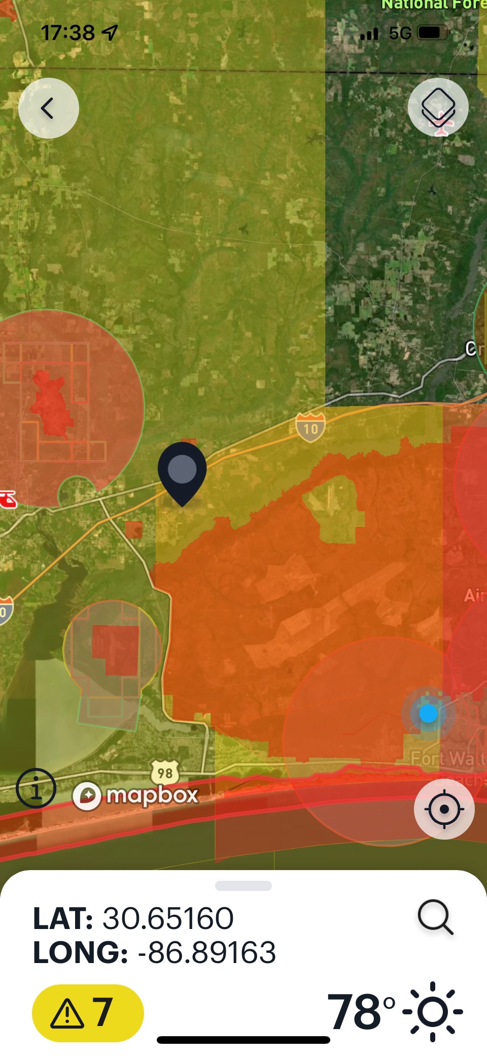

I do have Aloft and use it regularly for LANNC. It has this area in Yellow not like the the red areas that are prohibited. FAA's Viualize it web site indicates it is Class G. That is what adds to the confusion. Some SUA's list effective times, does that mean one can fly outside those times.

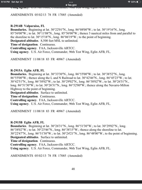

I am going to throw another question out there. Is all Special Use Airspace off limits to drone flying during the effective times as described. Example SUA A-292 has effective times Sunrise to 0100 Monday-Friday, Sunrise to Sunset on Saturday. That would leave only Sundays for Rec pilots to fly. The impact is that all of Escambia and Santa Rosa county's and parts of Alabama are a no fly zones during the listed times. Eglin reservation is a different animal with Hurlburt gunships and Eglin weapons testing. Tyndall AFB and Fort Rucker have their own SUA's. Leaving a small sliver of land in Walton county to fly if this restriction is true.
Reactions: captainmilehigh
P-xxxx: all flight prohibited within the area and altitudes listed in the sectional chart.
R-xxxx: all flight restricted within the area, altitudes, and times listed in the sectional charts. Contact information is given for getting clearance to pass through the area. GA can contact the control agency by radio, others must use phone number listed for control agency in the chart supplement.

@TontoFAC you can access the appropriate sectional chart using SkyVector.com. Scroll and zoom the map to your area using the World VFR setting, then select the New Orleans sectional. You can then scroll the map to access the left edge of the New Orleans sectional to find the listings for any P, R, and A airspace areas.
There was a statement you made in an earlier post about the area you are interested in being Class G airspace. That is only true when it is outside of the active times for the restricted airspace.
