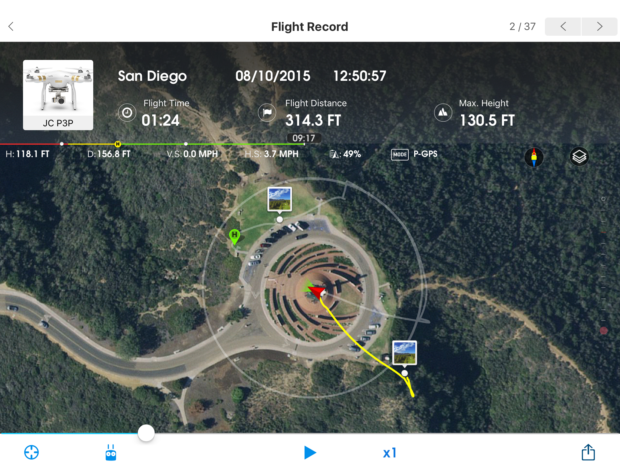

I have only tried 2-3 POI videos, but on every one of them my subject has ended off slightly off center to the left. I am confident that I'm centered above the subject when I lock in the POI.
Thoughts?
Thoughts?
I can see you doing slight stick adjustments..
Have a look at the flight log and see if you are directly on top of the structure when POI is initiated.
My hands were completely off the controller.
Mt. Soledad doesn't take well to misspellings. That probably explains it.I have only tried 2-3 POI videos, but on every one of them my subject has ended off slightly off center to the left. I am confident that I'm centered above the subject when I lock in the POI.
Thoughts?
I've noticed the same thing in every POI video I've seen so far. It probably has something to do with the GPS not being 100% accurate.every one of them my subject has ended off slightly off center
On a GPS that can return the P3P to within 3 feet of its Home Point setting, that can't be it. It is far more likely something in the way the orbit algorithm was written. It may very well be intentional, as a slightly off center POI is more interesting than a bull's eyed one. Think Rule of Thirds.I've noticed the same thing in every POI video I've seen so far. It probably has something to do with the GPS not being 100% accurate.
Your orbit circle looks quite circular and you didn't alter it inadvertently. It is simply the default camera angle in the POI orbit that is creating the offcenter POI. You can change that during the orbit, if you want it perfectly centered. It won't alter the circle radius or the circle.Also, I rewatched the flight log and there were no inadvertent stick movements during the POI loop.
Circle looks perfect to me, I cant see any corners
The orbit itself is perfect. The POI simply isn't bull's eyed into the center of the frame. It is always slightly offset for a more compelling view, unless you alter it.According to that flag, it looks pretty windy. How are your results in less wind? How about trying to correct by hitting focus? I do agree though- I like a less perfect orbit.
