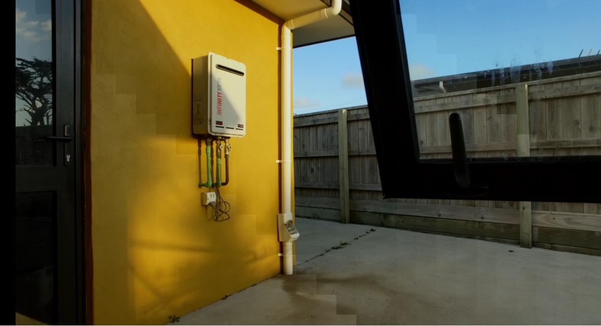

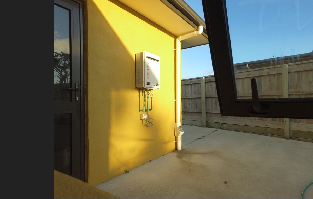

Can any till me what is happening to this video using shotcut
Took these images when pausing video ! took the photos using snip
On my computer
Before photo
And after photo using shotcut
Sorry just I have the phantom 4 standard
Trying to down size the video to put on utube using editing program called shotcut video editor
All the videos I put through it seems to have squares right through the hole film
On my computer
Before photo
View attachment 103241View attachment 103242
Yip I can see , the wall and bottom and on window,it's odd because it's like same shape as the brick work on the wall,,almost reflection but not,in noise reduction off in settings,make sure you have good sd card in aswell,some are rubbish,might to be something picking up some rubbish in transmission channels, try custom and run through them for best view,........OK me just notice you inside ,were you filming from in there,,I can see the small squares all over the screen but unsure ,almost to like grid line settings but it's not that either,is it all the time when recording
Just for those with bad eyes,,,,yes squares all over
.....that's why I thought of reflection

It's happened since last big update when I started getting funny green lines in my videos. I stopped flying for about 2 months to wait for another update green lines have gone now I'm getting these squares
I been right through my settings but can't find anything deferent of what I use to use puzzling

Wow took me 5 hours. But I've what the problem was. It was my VCL Media player causing all my problems looked closely at my videos on the sad card and bingo they all had it to so by chance look at through another media player and yeah it wasn't there anymore. Download another player and still not went to VCL and back it came
Thanks all your help.
If you're running VCL dumb it
