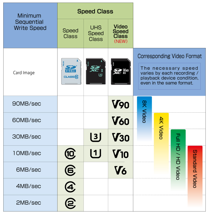

This sure MIGHt Help....i think your write speeds are way to low see the vertical yellow Bar.....V60 is for a 4K Video
V30 is waaaaaaaaaaaay too slow for 4K Vids. Good Luck and keep us informed what you do.Thanks

V30 is plenty good enough, 30MBs = 240 Mbs, four times the max bitrate of the phantom 3 SE (60 Mbs).

Thanks "With".... for making the answer more technical.....i learned something too...and the others sure did also....We are still learning ! was it you that posted the chart that i re posted above With ?
No... wasn’t me who posted the chart.
