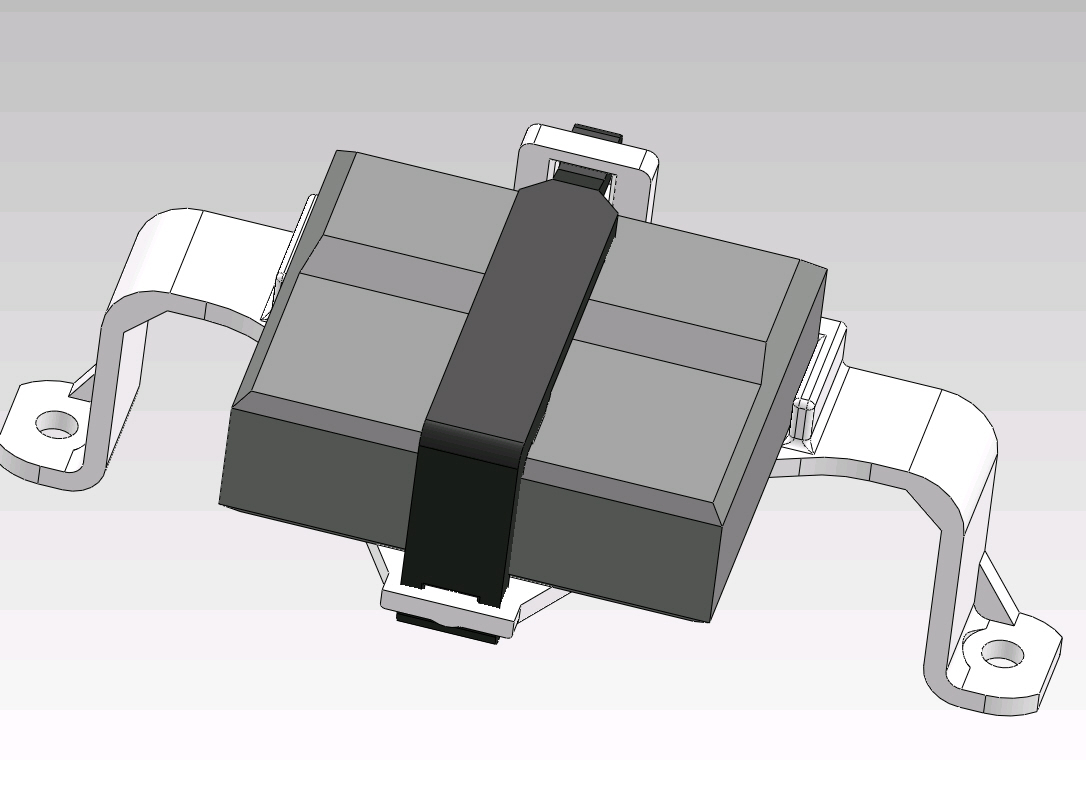

I modeled and printed this for my vision 2, never had a problem. Slung under the bird. It tracks, it is out of the way. I like it.
I could print more, once you have one, it is as easy as clicking the button....
The design was what took time, but as hobbies go, I wanted one so I did it. I added longer screws to the landing gear and was done. This is rev c or so, I may have revved it 2 or 3 more times....
The design was what took time, but as hobbies go, I wanted one so I did it. I added longer screws to the landing gear and was done. This is rev c or so, I may have revved it 2 or 3 more times....View attachment 19976

Your results may vary. I have no problems with any of the sensors on my vision 2 with the trackimo mounted here. I got it on Ebay new but without a data plan for $65.00. I need to pay about $5.00 per month to keep it connected. It tracks, it can do more tricks than I will need.
The bird also has 2 of 4 prong stabilizers snapped onto the back nacelles. I printed them to help with rough landing surfaces. They work.

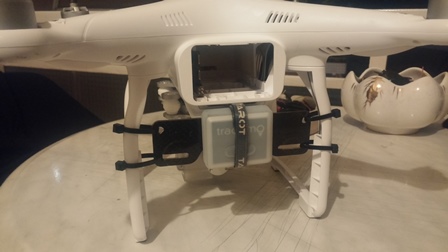

thanks for posting. The phantom 3 is a bit different though. That space is new reserved for ultrasound and visual sensors. Would have to be a side mount to work, as depicted in an earlier post.

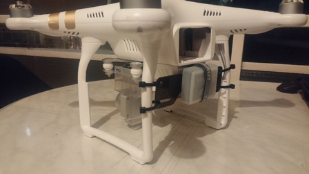

Wanted to say Hi as I have been lurking around here for a bit. I realize that this thread was about the Phantom 3, but I just added a Trackimo to my P2 this morning and was not very happy with the mounting I had so far. Delirious, I like that plexi install and will likely adapt something similar for my P2.
This is my trackimo mount. A little carbon with tire-ups, attached with velcro and secured with extra velcro tape. I will test this tomorrow...;)

I use a trackimo mount for the phantom 3 I purchased from Flying Ag and it works great and looks like it came with the Phantom. See it here.
