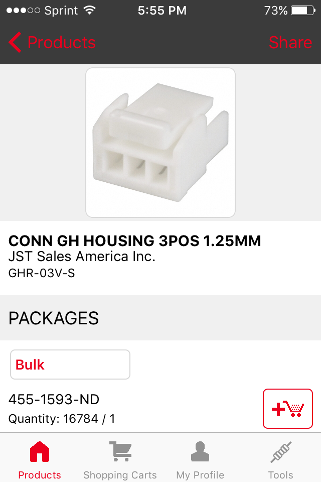

I got the parts from ( DIGIKEY.com )
If you have a p2v non plus, you'll need this plug
( plus model already has this plug we can use )
Part # 455-1593-Nd ( GH 3 pin connector )

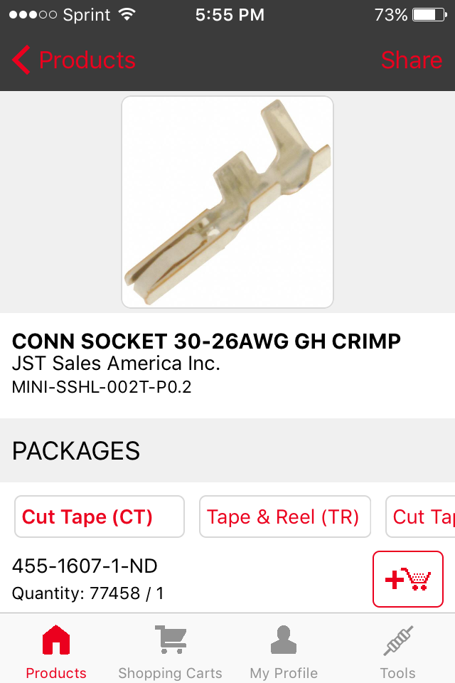

Now the GH connector requires 2 ( but buy more as they are easily broken ) pins.
Part # 455-1607-1-Nd ( GH pins )

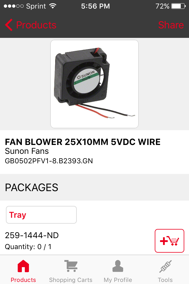

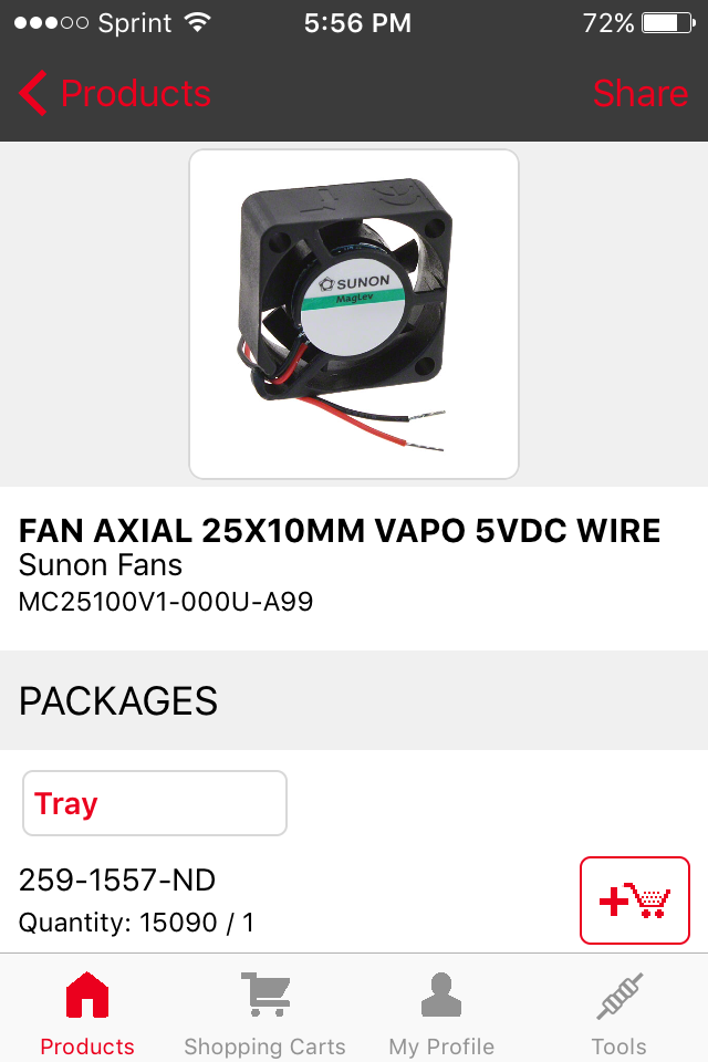

Now there are 2 fans I chose ( ultimately picked the BLOWER fan ) as it seemed more focused on the board and components, where regular fan just blew into battery compartment. But here is both.
Blower fan
Part # 259-1444-Nd ( blower fan ) 5vdc
Regular fan
Part # 259-1557-Nd ( regular fan )

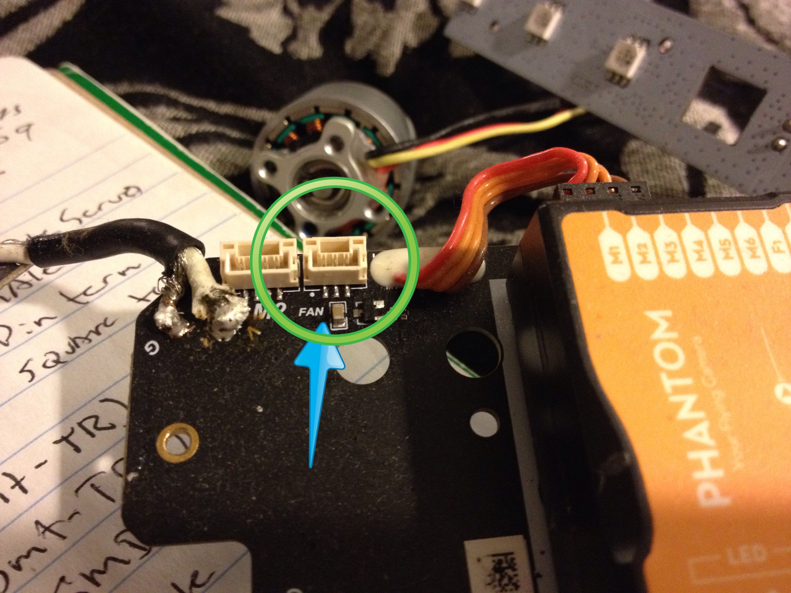

Now the funny part, it plugs into the FAN PORT ( lol )
You'll use the 2 outside pins ( as plus model already uses center pin ) looking at picture ( LEFT PIN ( Pos.5vdc ), RIGHT PIN ( Neg. )) center pin ( Neg as well ).
I hot glued my fan onto side of phantom bottom half, directly over a vent hole, and the blower blows straight up through a cutout on mainboard, and directly onto top board and components! Does not blow a LOT, but DEFINATELY makes a difference, especially on plus model, to keep wifi module cool!
