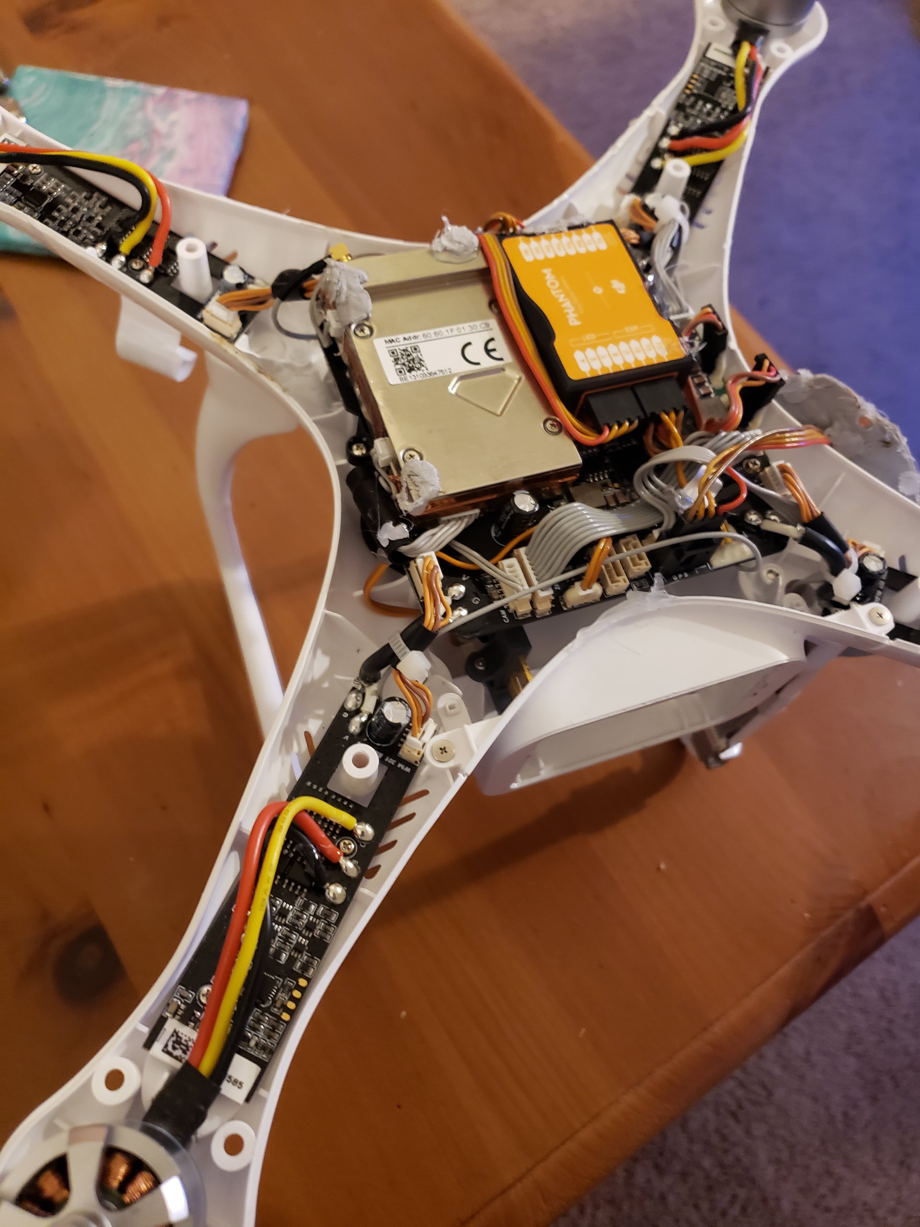

Starz, thank you! you have saved me a tremendous amount of research and possibly money trying to figure this out, kudos to you! So do I unscrew the small rectangular circuit board leading to each propeller and align them in a different order or do I need to unsolder the wires and make them all in the same sequence?

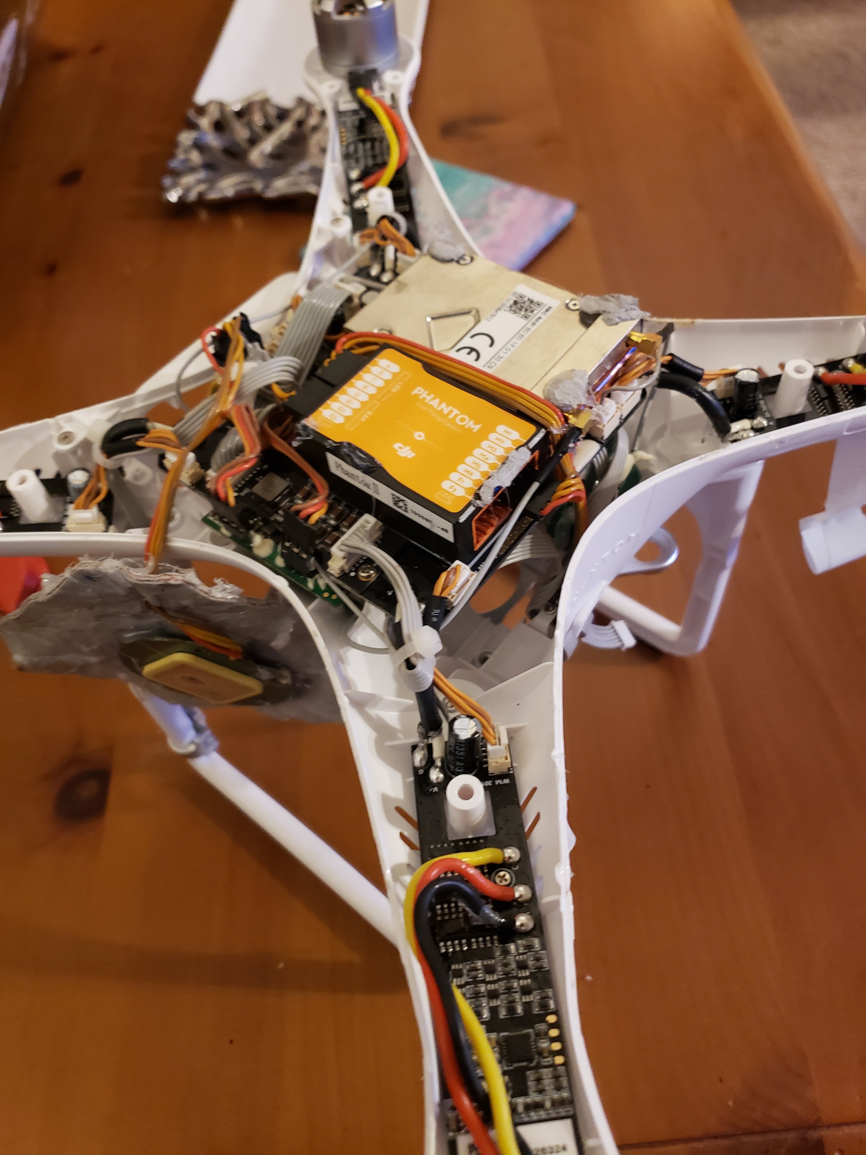

Without more info and more pictures, I can’t say what the next step should be. It did not look to me like the wires from the motors to the esc’s had been fiddled with so I think if there is a motor direction issue, it’s somewhere else. A few pictures of the Naza fc will help to determine if those wires are possibly mixed up.
I'm wondering why they would have been switched around .The previous owner had to have been in there for some reason.
/Yeah I see zip ties but the esc's where they are soldered look like factory to me. But been awhile since I been in one though.

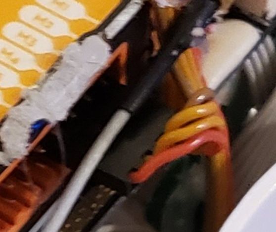

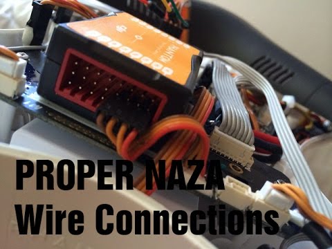

Sorry im a bit confused, your motor wires (black yellow red) are all in the right order, when i have seen this issue it is the plug in the NAZA that has been put in the wrong way, it's the 4 wire plug that comes from the board and should have the red wire on the right side of the naza unit, the 4 wire sits underneath the top two in the middle set of pins, i can see the red wire is on the left in your picture
it should look like this
As I remember these connectors, isn’t there a couple of tabs on them that matches the small slots at the bottom of the controller?
