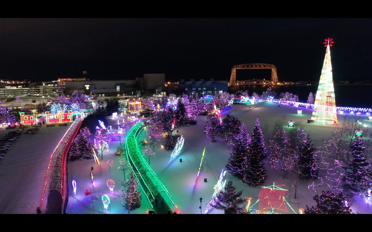

I shot this last night. Different conditions but the bridge in the back is about a mile away.
ISO 1600
A 3.5
Shutter speed 30 fps
I actually forgot to turn mine off in that photo. Its a screen shot from the video we took..

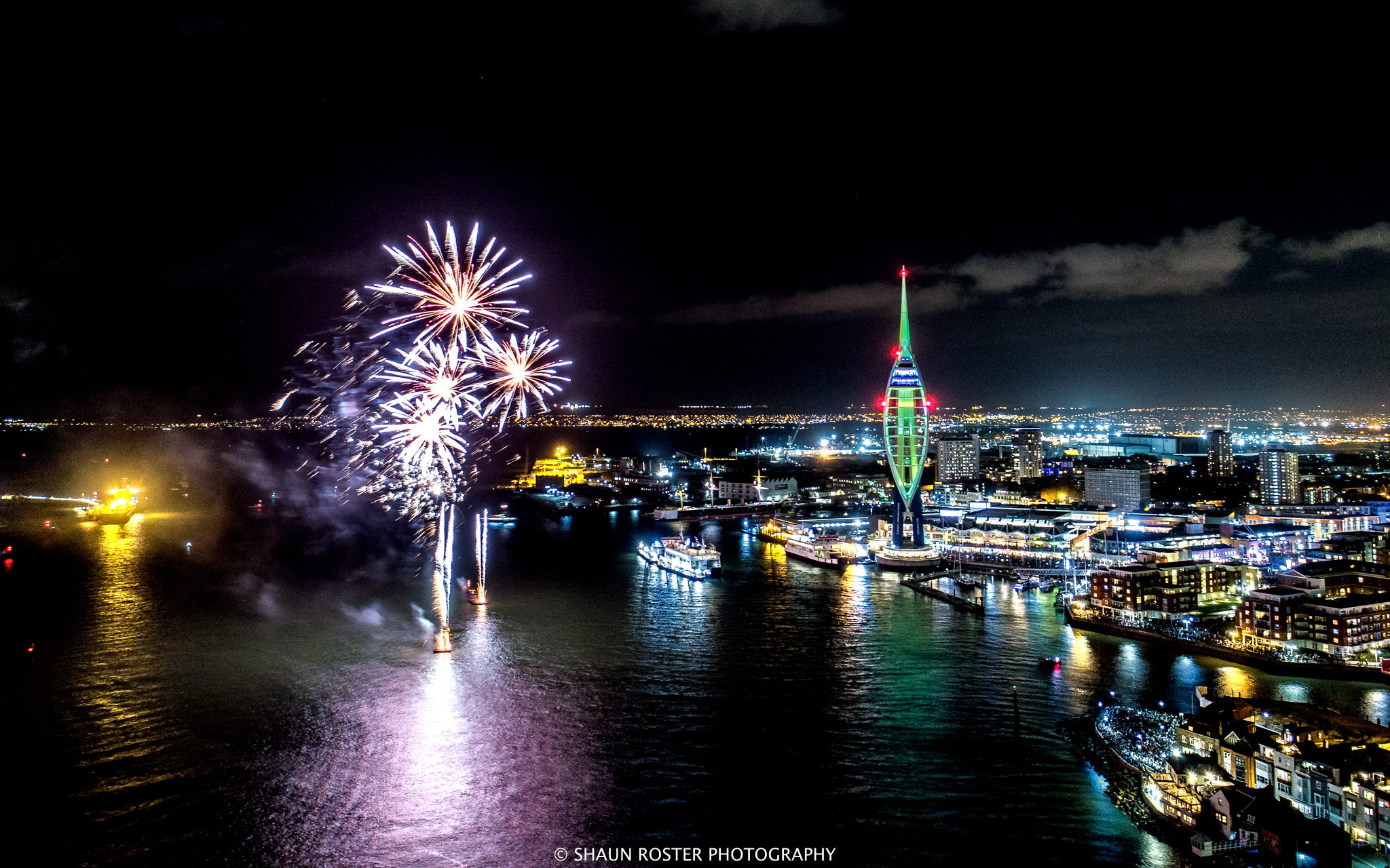

This is a fireworks image i took last week, although I had better light levels than you're suggesting you'll have, so I was able to keep the ISO lower so as not to over expose the light bloom, it was windy as hell.. Gusty 15-20kts which really limited me to keeping the shutter speed low.
Phantom 4Pro Obsidian
Shutter 1sec
Ape f2.8
ISO 600

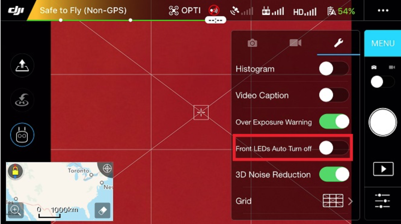

You can have the LEDs turn off automatically each time it takes an image .. as per the attached screenshot
Yeah, I know about the menu setting to turn off the red leds on the front rotor arms.
I was talking about the 3 mile visible anti-collision strobes needed for night flights.
