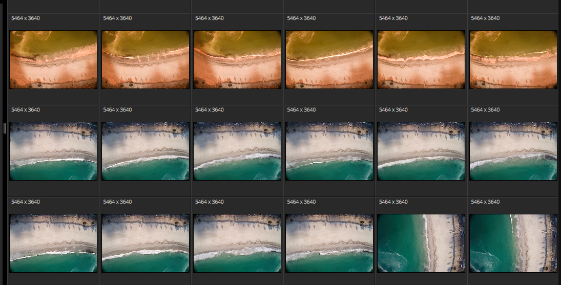

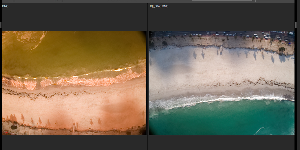

Here are the examples.
As you can see the ones that have turned upside down are the ones with the orange cast. Obviously I did not turn the bird around - neither did I change any settings. The images were shot few seconds apart from each other...
It is very clearly linked to the flipping problem discussed on different forums...

Wow, it looks almost like in addition to the 180 degree rotation, some of the channels are inverted, but that is not it.
No idea how to save these.
