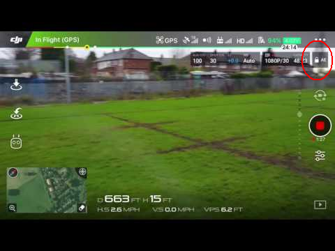

I personally like shooting using the VIVID color setting. The saturation is fairly high, but it makes things pop and I don't have to grade it in post, rarely ever. There's an EV lock icon in the upper right corner that I think you can touch and that locks the exposure. I usually don't lock it myself, and my videos usually turn out awesome, IMO. I like what I see in my video clarity, contrast and colors, others insist on grading from Cinelike or None color setting. Try vivid, you might like it.

Hmmmm will have to try this. How do I get the lock AE icon on my display like you have in the upper right hand corner. I cant seem to find it in the settings to have it show up
