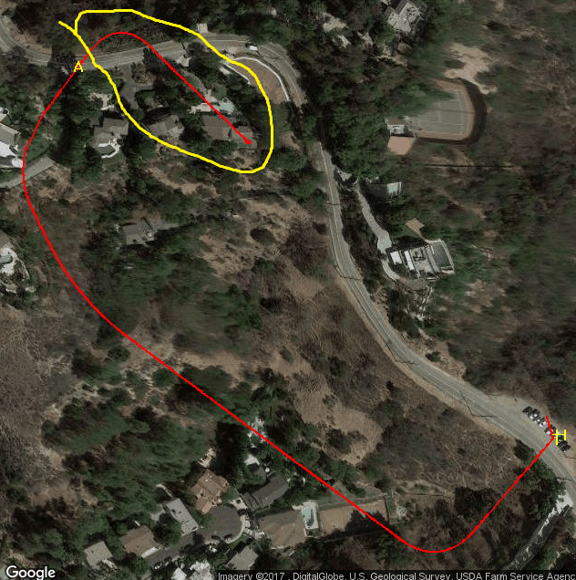

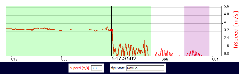

The .txt is what I was needing. The PhantomHelp link will show a page with a link that will allow the original .txt to be downloaded.
This .txt had two WP missions. Possibly the first WP mission is in a separate .txt; a new .txt is created when the P4 is landed. In this .txt it appears that the WP missions are identical, but the first WP mission was aborted and the P4 was brought back to the home point and the second WP mission was initiated.
At time 647.86 it appears that the P4 while still in WP mode stopped and started thrashing around.

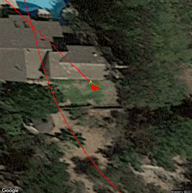

The GE image doesn't show anything that it would've hit. Maybe the image is off some.
You asked about the control inputs. Might be a little hard to interpret.
This shows that the throttle had just been pushed all the way forward. The elevator was pushed all the way forward a few seconds later.
It looks to me like the WP mission path took it directly into what ever it hit. The first WP was aborted before it got that far. The flight actually lasted for another 36 seconds. When the RTH button was pressed at 674 secs it couldn't. From your description I'm supposing that it was hung up in the tree.

Another possibility to consider is that the WP mission actually includes hitting the tree. The first time it was aborted when you thought it was close to being done but it actually had a lot more to go.
The A symbol marks the spot where it was aborted the first time.
I'm not familiar with the DJI Go App WP planner. Is it possible that the mission actually includes the segment outlined in yellow?
