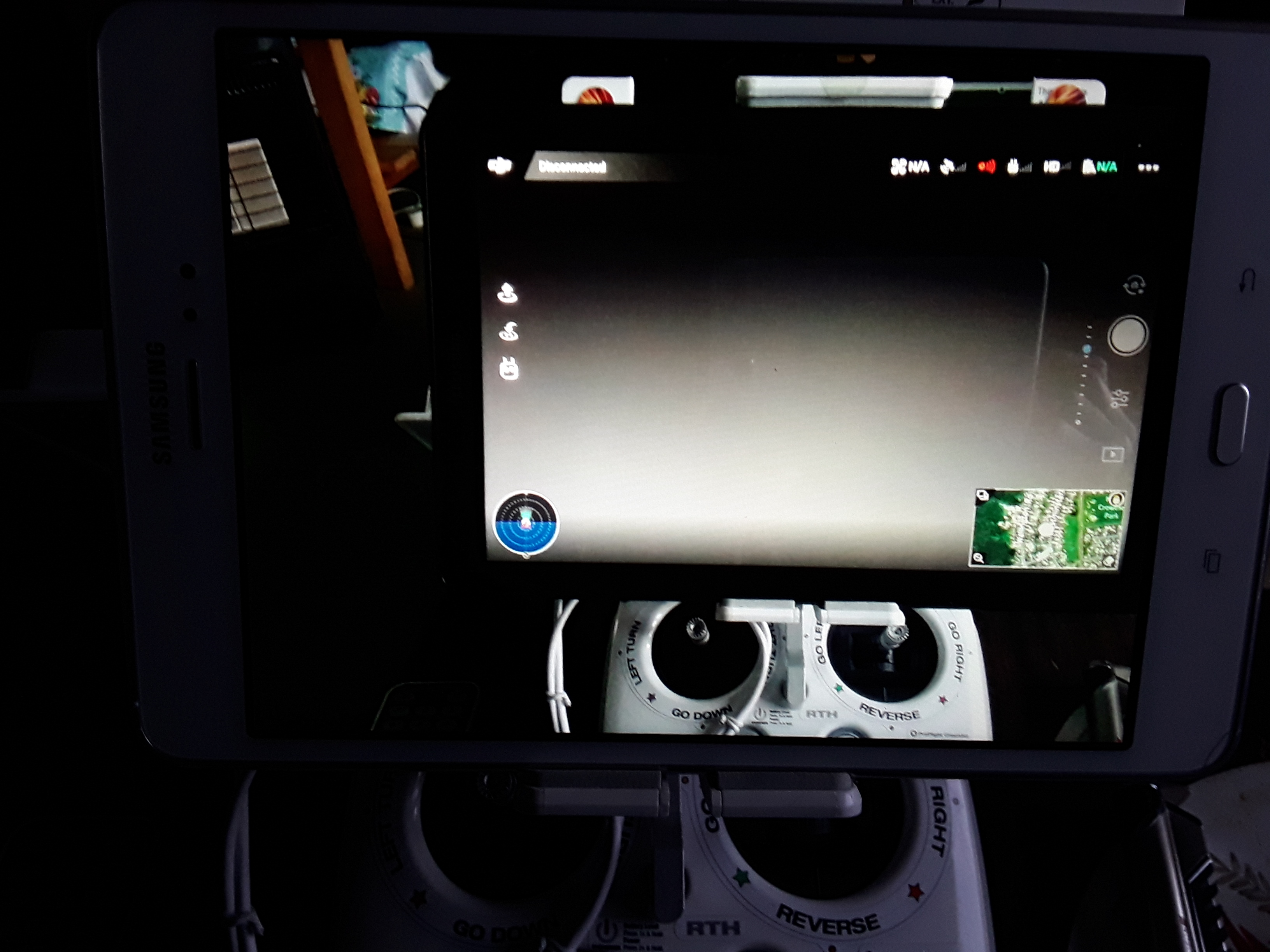

For the last couple flights my DJI app will not load any map view at all. It powers up and says, "the home point has been updated to check it on the map." Only thing there is no map. I have had to switch over to my Litchi app for back up and it shows everything just as it should. I just don't get it... I have even deleted the app and reloaded it to get the map to show and it does. My cellular data is working to cover not having wifi. This problem has also happened even at my home, no map showing at all. Any ideas that I have not tried?

Different equipment bur same behavior: P3P, iPad pro 9.7, DJI GO 3 - all was properly working before last update, now with 1.11.0020, app 3.1.14 no more maps no matter what I do. IOS Maps app works fine, in Litchi maps are there... recalibrated all after update, Gps satellites >14
Also video signal more unstable than before and got crazy to override the 30/50 metres limits even if logged in
Seems this version of app is very bad, hope an update arrives soon.
In the meantime I will learn to use Litchi
After a few batteries more of experiments I found this workaround (it works on IOS, no android device to test on). It worked reliably for me, tried some variations in the sequence but this below is the only one that worked
1- start DJI GO and in the gray "map" lock the map orientation (tap on compass needle to overlay a lock on it) - this setting will be maintained, so it's only needed once (the first time)- exit DJI GO (unload from memory)
2- start RC and Phantom
3- launch Litchi, the map will be there
4- exit Litchi (unload from memory)
5- launch DJI GO, the map should be there now
6- hopefully you can now take off...
