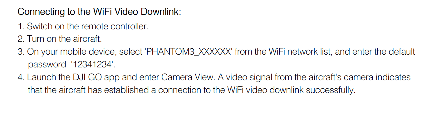

Let me ammend my post #7....I just realized this is a P3S. You wont need to change anything in the developer settings since this uses wi-fi only and not USB as all the other Phantoms. Have you read the the full manual? If not you can find it at this link.
https://dl.djicdn.com/downloads/phantom_3_standard/20170623/Phantom+3+Standard+User+Manual+v1.4.pdf
This may or may not help in setting up your phone, but it needs to be read anyway at least 3 times if you have not done so already.
