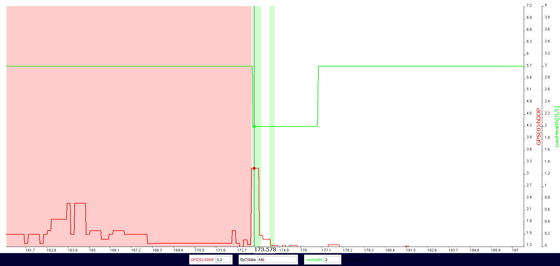

@BlueVista For the sake of clarity, below is a closer view of what occurred. You can see the GPS(0):hDOP spike which cause the actual termination of the mission and the switch to ATTI with the navHealth drop.
[...] You can see the GPS(0):hDOP spike which cause the actual termination of the mission and the switch to ATTI with the navHealth drop.
Okay, so... now what?
What would be causing this type of GPS problem?
Is it something wrong with the Phantom itself that could be addressed in some way?
It's also a little bothersome that I couldn't simply re-try the mission, because of that very odd error message.

The answer is the same as it was in June. Take a look here
Litchi waypoint missions never complete - they simply stop mid way
This flight, FLY119.DAT, has the same problem exhibited in FLY102.DAT back in June.
