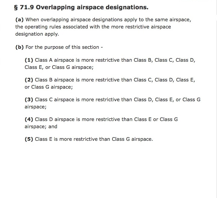

Well, in the linked document that dok sent, there was a reference to Part 71 which "describes" the function/limits of each layer of airspace. I did some poking around and found this.
This tells me that since Class D is more restrictive than E, we must follow the operating rules of D, which says "becomes Class G after xxx hours". I think its a legal leg to stand on. I don't know about you guys, but I've missed a couple of jobs because of this same situation. Now I'm keeping a copy handy.
Well, just for argument sake, I see how you came to your conclusion, but the premise, "since Class D is more restrictive than E, we must follow the operating rules of D", is flawed. When the D is inop it becomes G, so there is no longer D to to be more restrictive then the E. So, the E, (which you can't be sure is not there), is certainly more restrictive then the known G and I would have to defer to E rules.Well, in the linked document that dok sent, there was a reference to Part 71 which "describes" the function/limits of each layer of airspace. I did some poking around and found this.
Right again! Explained in clarity with such an economy of words, too.The distinction here, however, is that they are adjoining, not overlapping and so that guidance, while correct, is presumably not applicable.

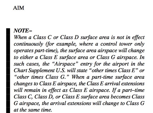

Oh buddy! You have solved your issue. There it is in black & white and taken from the AIM. Copy that and carry it with you. Good Job.I hate to beat the horse, but I was still curious and continued digging....I found this in the AIM dated 5/26/16. This was in Chapter 3 - Controlled Airspace. The last sentence in the paragraph is what I'm thinking is my answer.

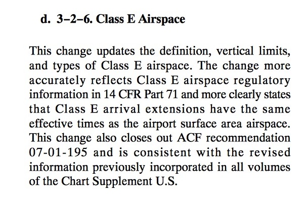

The second caption is also from the 5/26/16 AIM in the front of the manual. It is part of a listing of several changes that have occurred between 2012 and 2017.
Am I on to something fellas?
