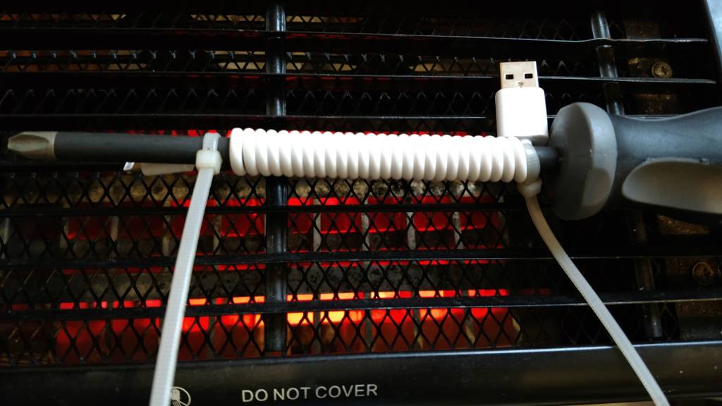

First post. Hello everyone, I saw this and had to post something because this has been an issue for me as well. So I did this to a cheap wal-mart lighting cable. I use a round shank screwdriver and two cable ties. I tied the USB end to the handle end of the shaft with a small cable tie then wrapped it all the way till I only had enough to tie the other end with a cable tie. The I heated it over a heater for about five minutes. I removed it after it cooled and this is what I ended up with.
I'll probably pick up a short cable next time I'm around the Apple Store. This one works better than the wound up way I had it before.
LOL- that is awesome!!!!
And much better than anything you might get someone find for you and to ship you for free and under $10 total.

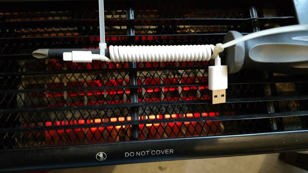

Here's how I did it. About ten minutes on the heat. Five on one side then flip for five.View attachment 74803View attachment 74804

Nice, simple and practical. It's the OEM internals also which should give comfort. The super cheap cables aren't worth fiddling with (my experience) in imortant applications- risking losing FPV and telemetry in flight to save a few dollars is false economy. A friends son who imports all sorts of rubbish gave me a handful of very fancy looking lightening cables. 4/5 died in normal use within 6 months.
