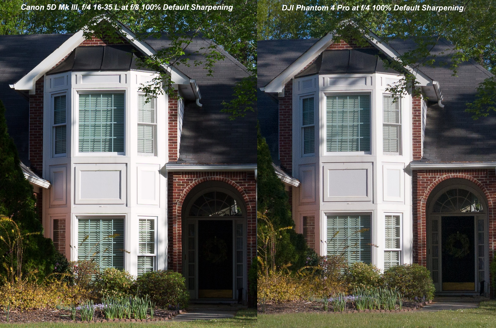

With my curiosity having been aroused from another thread, I decided to go to my front yard today and take two photos of my neighbor's house across the street. One was taken with a Canon 5DIII (roughly 20MP) with the newer f/4 16-35L. This lens is much sharper than the f/2.8 16-35 Mk II, BTW.
The second was taken with my Phantom 4 Pro, being handheld like a really awkward camera. The shutter speed for this was 1/1000 so any movement associated with awkwardly holding the drone while pressing the shutter should not appear. I did use the ''half press" auto focus with the Phantom.
This crop is from the center of the frame. I also looked at the edges on both photos. In the edges the Canon clearly wins the battle, but not by as much as you might expect. If anyone is really interested, I can post a sample of an area that is off center.
I opened both RAW files in ACR and used the default sharpening settings. Color was tweaked a bit to try to get the two images a bit closer to each other.
I will let readers come to their own conclusions...

I'll take the canon
I will too, as long as I am shooting from the ground. If I need an aerial perspective I will not hesitate to use the P4P.
It looks to me like I got a good copy of this lens or something. Or maybe my focusing system is somehow working better.

Kinda of interesting, viewing pictures that are not the complete file, on various video cards, and monitors, and with unlimited number of variables. But the point is well illustrated.
Looking at the pics, there is more visible detail on light and shadow in the P4P due to less contrast, whereas the D5 is blown out in areas. Question is, if the contrast, saturation, and colour were adjusted closer, how different would they actually be? To me, the difference is more due to post adjustments than anything. A touch more green and contrast to the P4P image, and they would be much closer.

Looking much closer... I do see the P4P has more grain in shadows.. that is harder to adjust for.

IF the 5D image truly looks blown out (values that are clipped at white) then it is going to be your monitor. The image has no clipping other than the white text. It gets close in the brightest spots (251, 250, 254) but not truly blown out.
