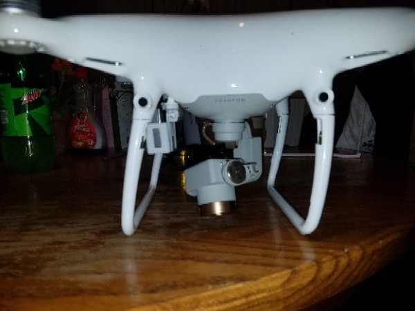

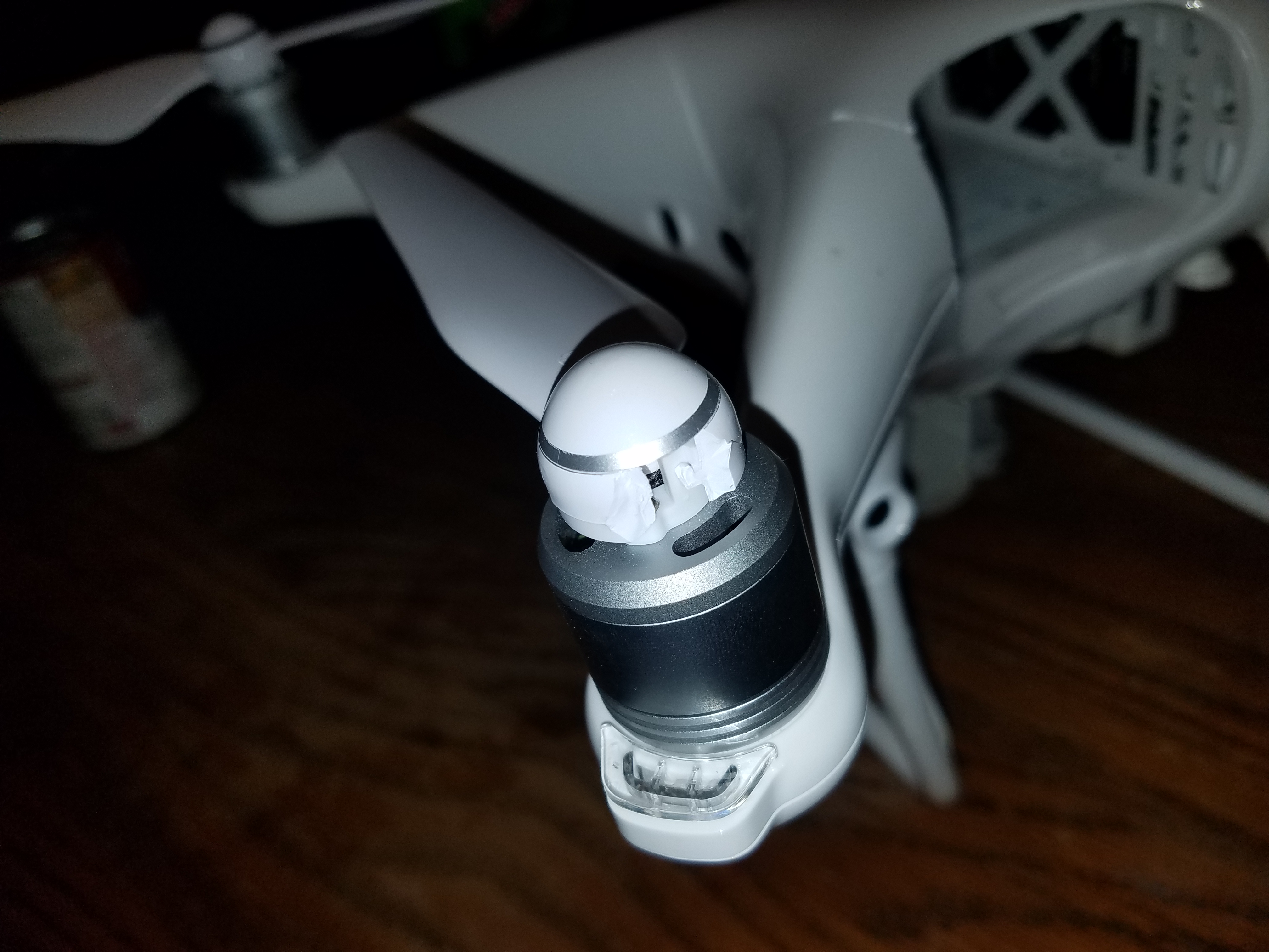

Has any one ever had a prop just snap ...they were factory p4p props flew for bout 5 mins flight was fine was descending got to bout 50ft and snap came crashing down ...didnt hit anything not even scratch on the prop ..and a really clean break
111345
111346
Has any one ever had a prop just snap ...they were factory p4p props flew for bout 5 mins flight was fine was descending got to bout 50ft and snap came crashing down ...didnt hit anything not even scratch on the prop ..and a really clean breakView attachment 111345View attachment 111345View attachment 111345View attachment 111346
Mate sorry to see,,inform dji if haven't already,,still under warranty?? I see new drone here,,NO have not seen break there but very similar,,hard to stop flaws in manufacturing process , they should x-ray like helicopter blades ,,,good luck and post a update,,

I have the refresh care so replacment will be 99 got drone In. January 19 it just sucks what if it happened over water would be screwed .I probally could get them to cover under warranty but will take a lot longer for them to do investagation
Apparently turn around time from dji has got better from some posts I read so might have back sooner than lately,,clearly not your fault,it does sux sending any drone away but think you should or you could run in to issues changing things ,,who knows what happen inside drone,you could repair your visible damage and it might not work properly again,,see it here all the time,,,each to there own but me I would contact them,,best of luck and hope you in the air soon
I'm pretty sure I get a factory refurbished replacment ...
