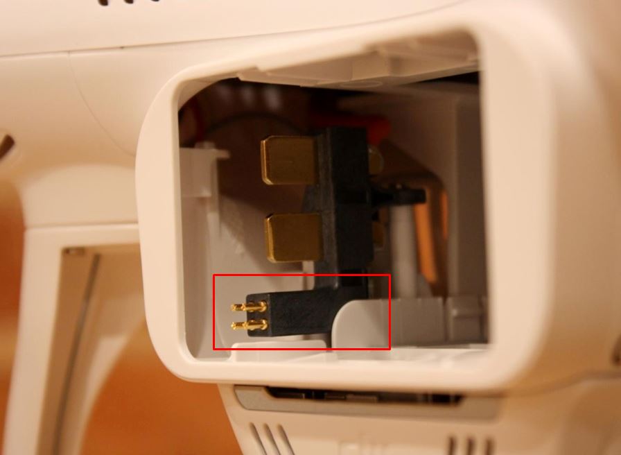

After replacing the shell, I did not see any other damage, when I power everything on, I get a warning, Motor overload. Aircraft will decelerate. Then Battery Error. There is no battery telemetry being sent from the P3Pro. Any help out there? GPS works, Compass calibrated. Under Aircraft status, it says Invalid Battery, any ideas out there? Thanks in advance!!
sure did. I am wondering if there is a data cable I might have missed...it was a pretty good crash, the mother board was knocked loose, I did not see any breaks in the board. how does the data from the battery get to the mother board and then sent to the RC?
Reactions: mmp3
Usually when people have posted a similar question, the issue is the cable that goes to the small spring loaded data pins. Perhaps give that a quick check.
Reactions: JoBe
yep, you nailed it, I missed the little two wire connector into the mother board...thanks!!
