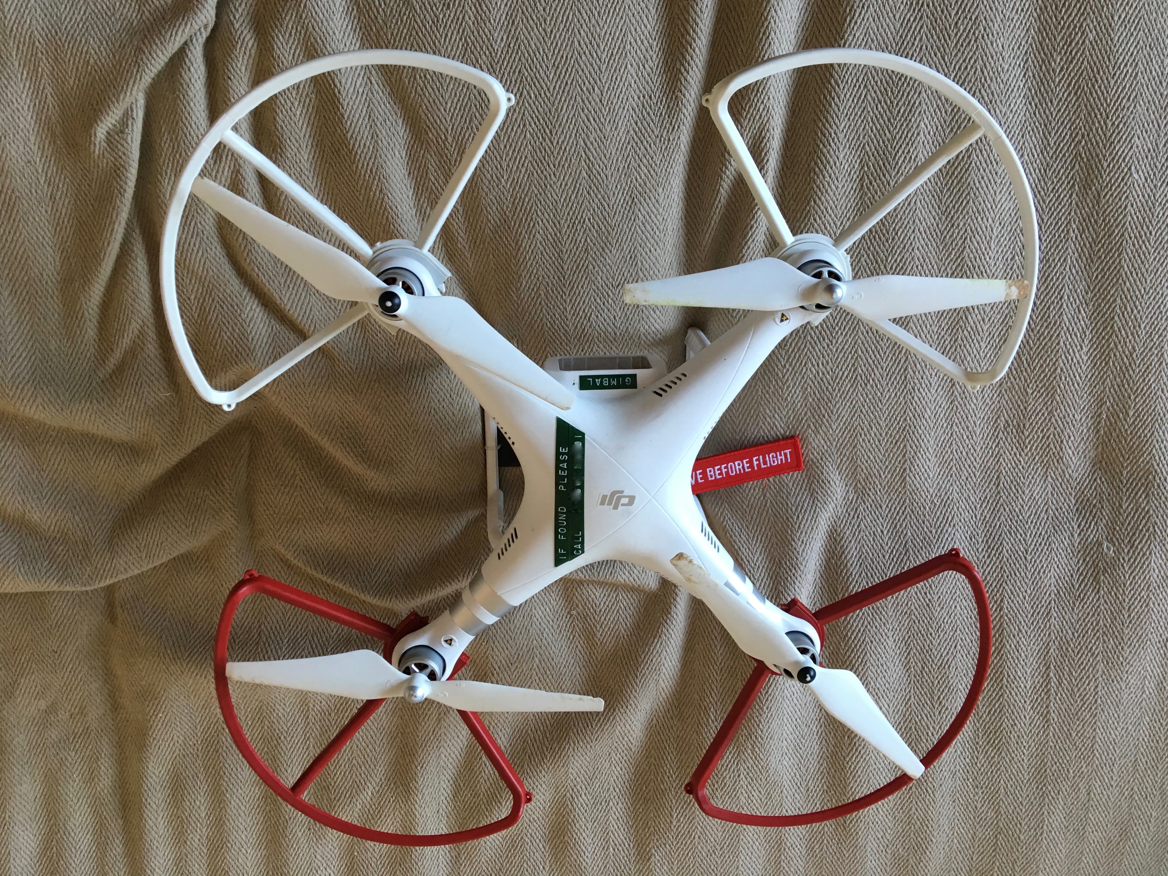

Here in the UK you couldn't do much better than these.

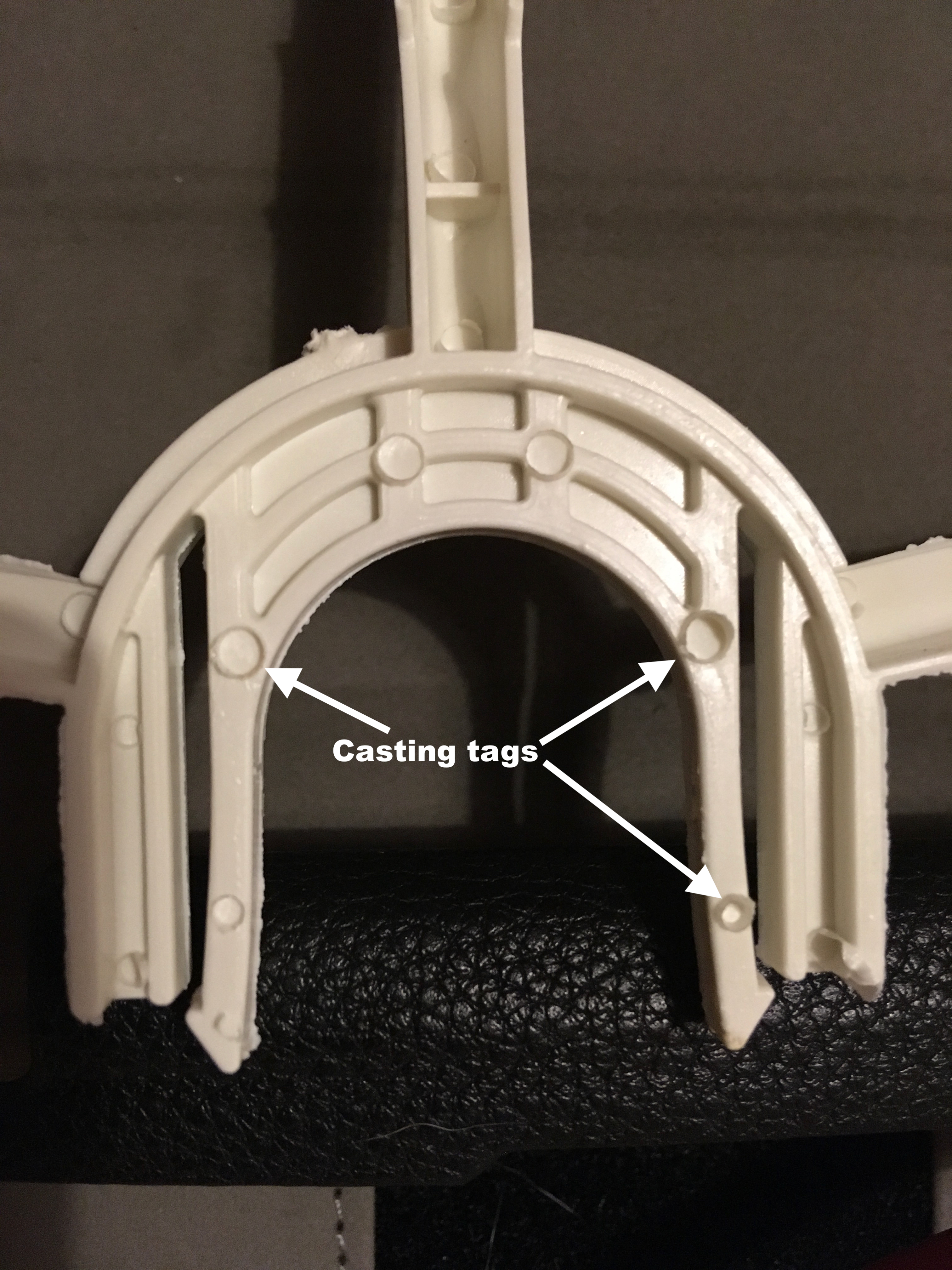

However, you will need to trim the moulding tags from each blade before you attache them to the mounts or they will jamb!!
Couple of minutes with a sharp knife solved the issue! and they just slide on and off!

What does that mean to remove the molding tags from blade?? Are you actually cutting a piece of your rotor blades for the drone?? If so, NO brother don't do that find the time to acquire the propper guard designed for your platform. It may be an insignificant modification but it's probable that this will cause maintenance issues for you due to drone being off balance from said modification.

Read the post and look at the picture before making such a silly reply! Oh, and these are made specifically for the Phantom 3.

Thanks for being rude in a cool way...I saw the pic.s and I can't see how these guards are meant for DJI Phantom / OEM products... I suppose by cutting tabs off you're able to reposition guard further out allowing props to spin freely makes sense now...cheers

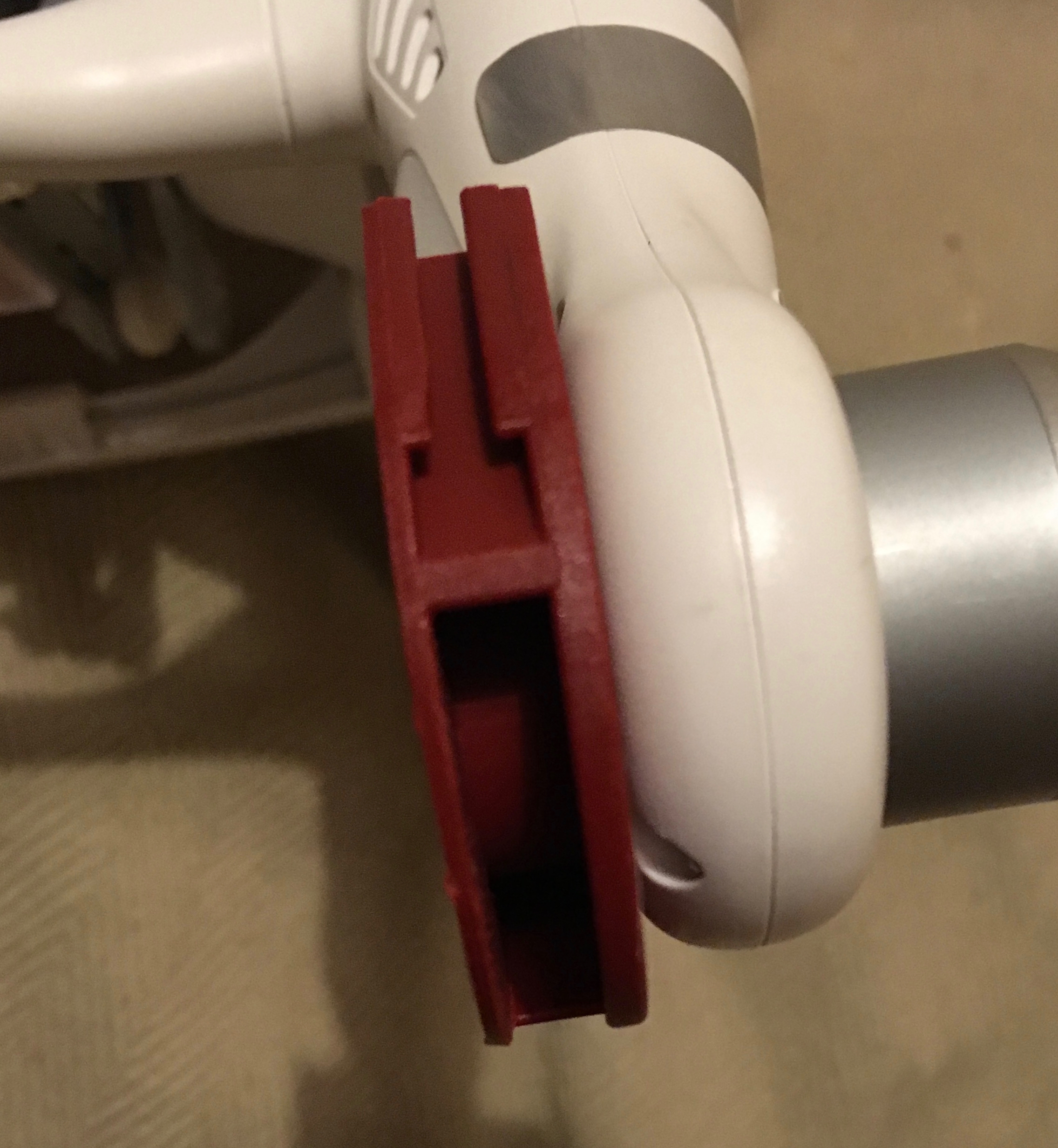

There are four mounting brackets that screw onto each arm of the Phantom 2 or 3 using slightly longer bolts (supplied) into the motors, two red for the front arms
and two white for the rear arms
into which the propeller guards slide and lock with little catches.
The casting tags are little bits of plastic left over from the moulding/casting procedure and if you don't trim them off they stick inside the mounting bracket making it very difficult to install or remove the guards. You are NOT cutting the tabs off, just the little bits of surplus plastic on the tabs.

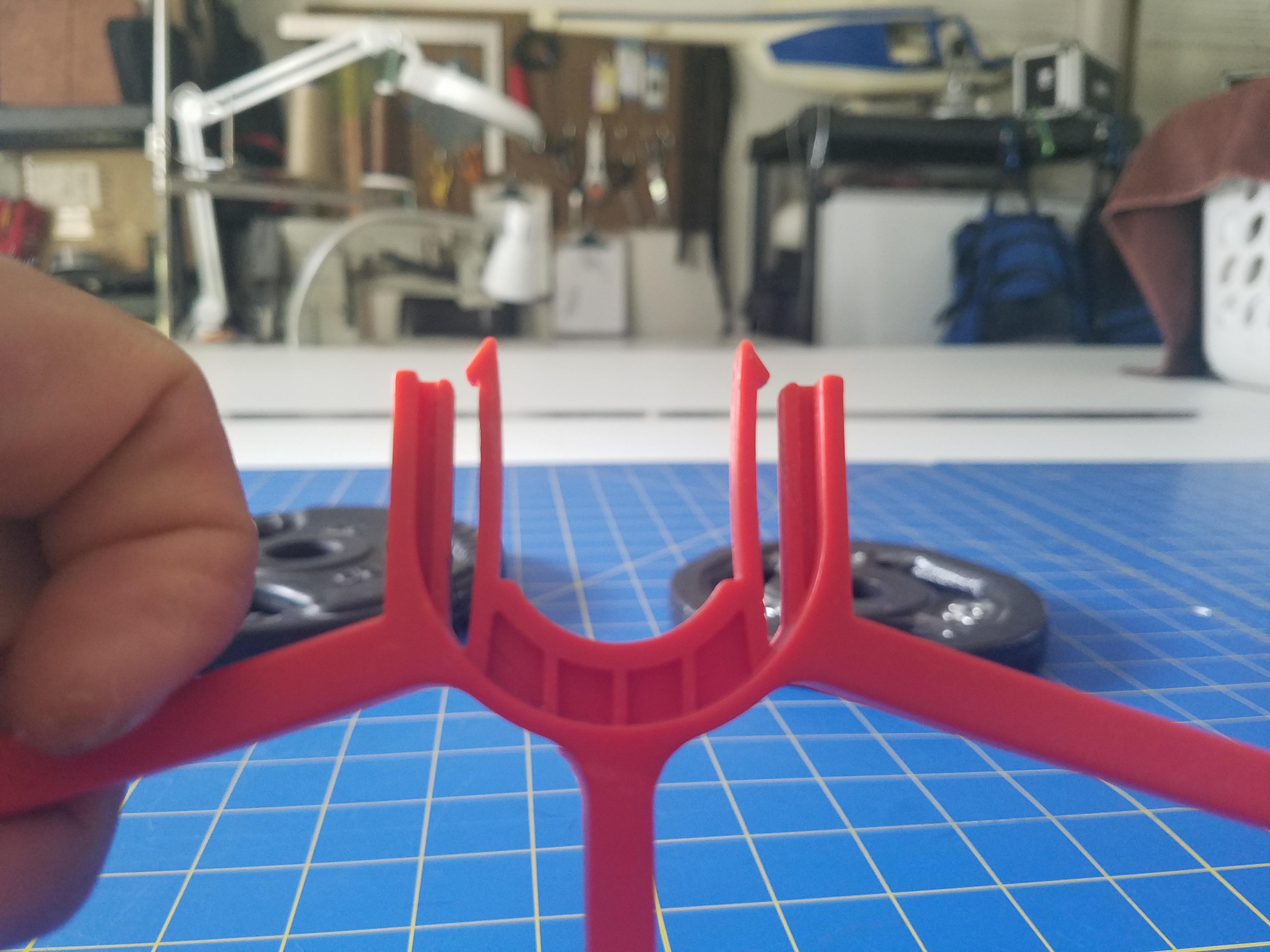

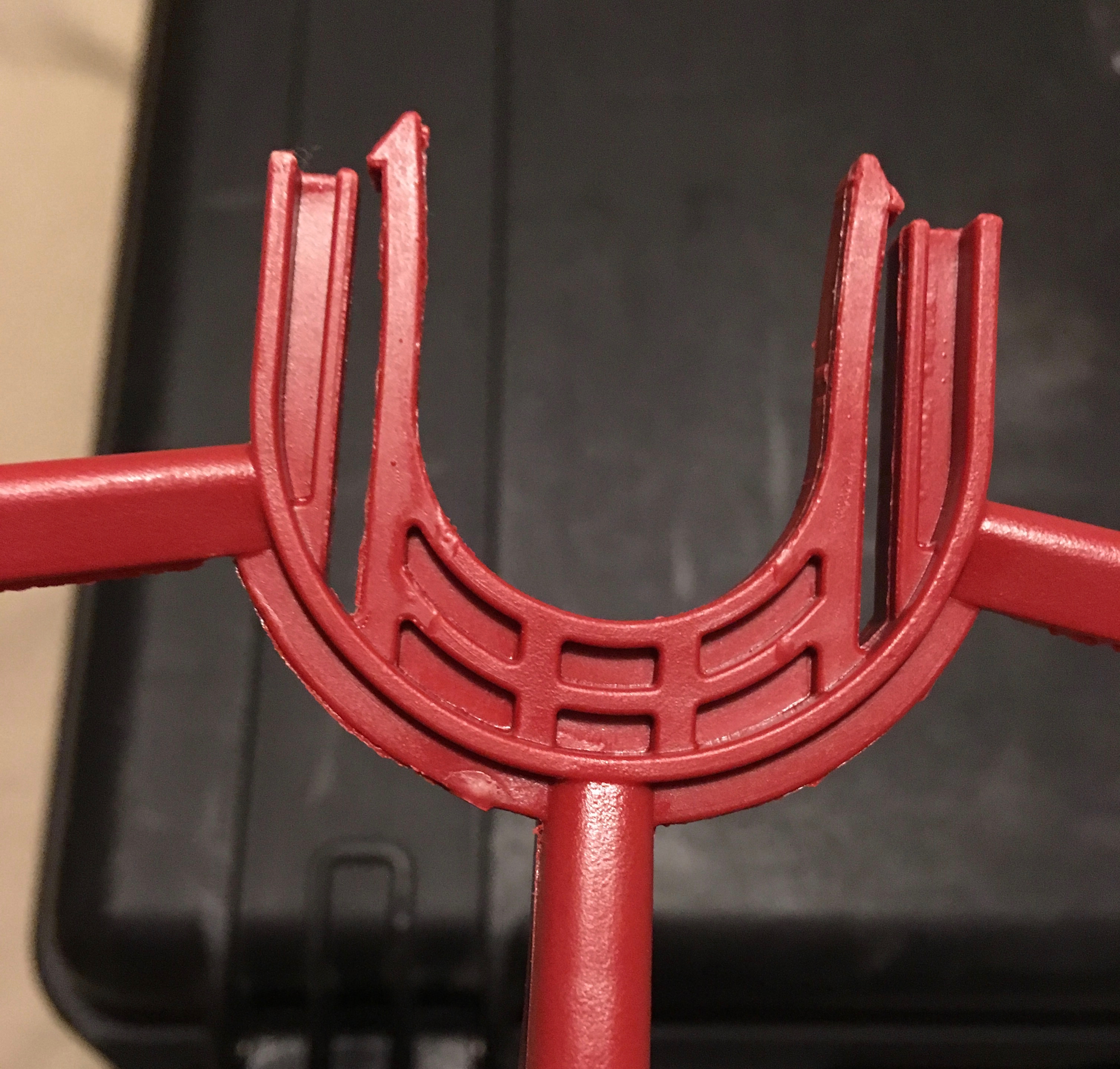

Hey guys this is to help you understand me. I pulled out my gaurds to compare and there are some subtle differences
Slight difference, yours looks a bit flimsier than the ones I bought? Exactly the same principal though.
