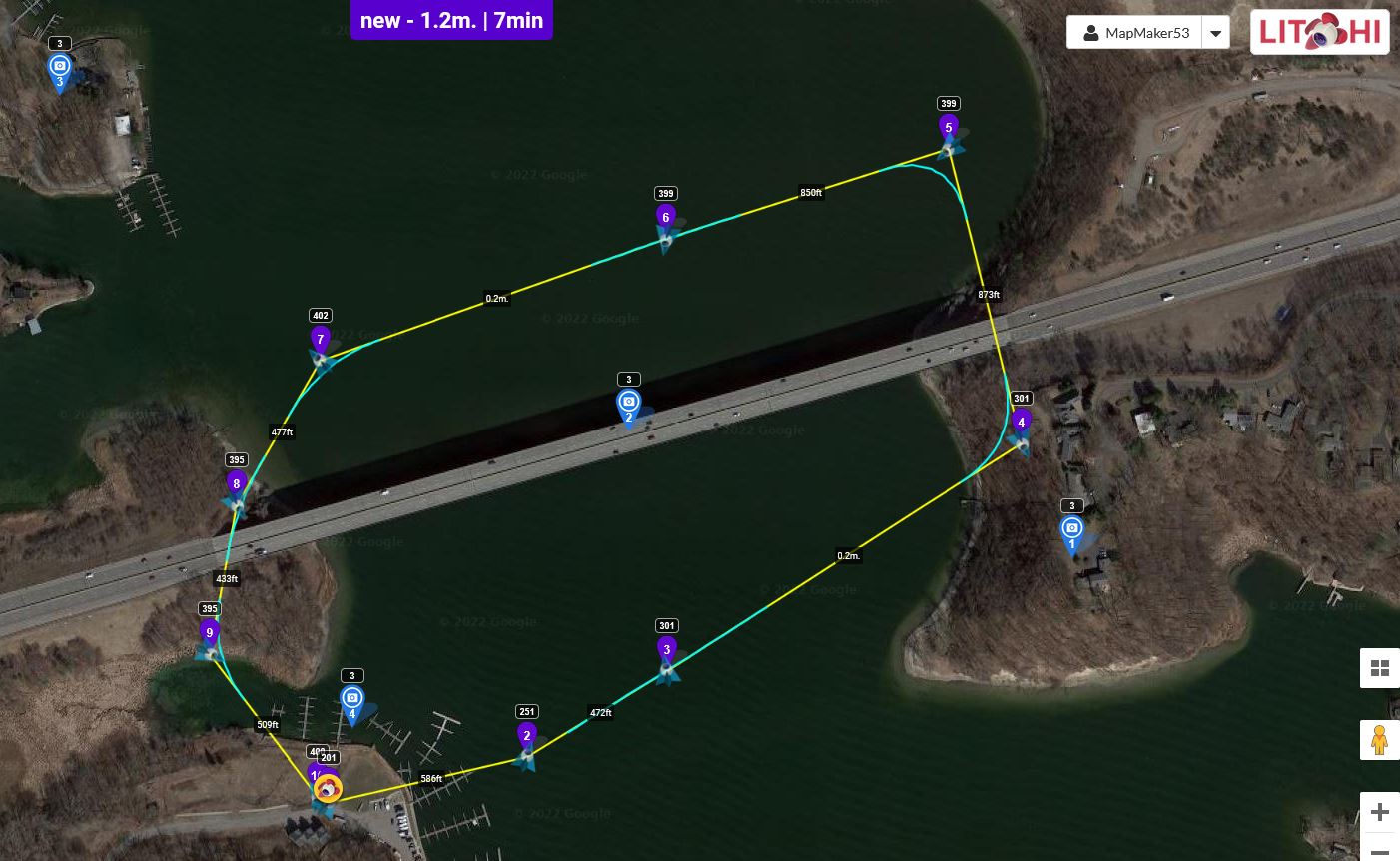

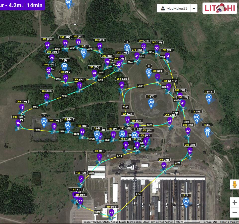

Another tip is you can place camera points of interest (POI) anywhere you like with right clicks of your mouse. For example.. Here you see a simple mission that incorporates four POI locations (camera icons) and each waypoint is instructed to aim the camera at any one of your choosing. Missions can be as complex as you want to make them.
